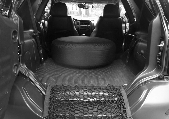

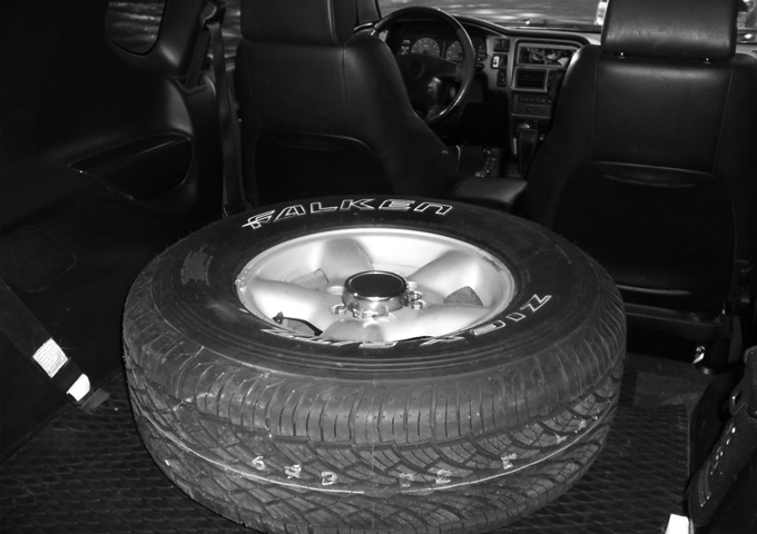

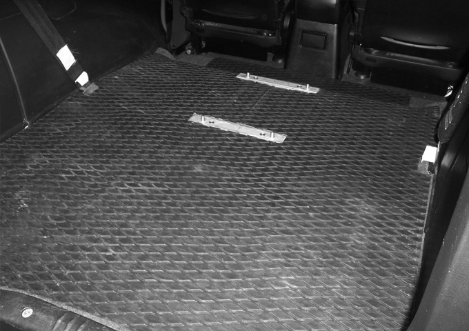

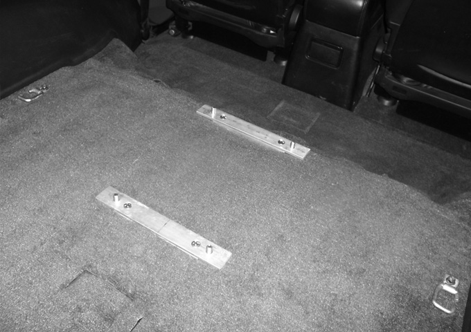

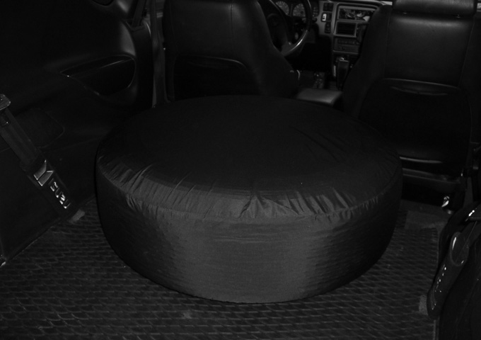

Solution: I saw a 1997 (I think) Rodeo at the local Pick 'n' Pull. It had the spare tire mount attached on the outside of the back door. I got the mount and measured it for fitment in the back of the VX. I fabricated some mounting brackets that fit flat on the floor and bolt up nicely to the mount. The floor is corrugated so it's best not to just bolt through it without a bracket. I had the mount sandblasted and powder coated in gloss black. I positioned the mount so that when the tire is mounted to it the front seats can be in the full back position and reclined without touching the tire. There is still room to conveniently stow things immediately behind the seats and plenty of storage room at the back. I cut a 22 inch diameter circular piece of .125 inch thick Masonite to fit horizontally on top of the tire and got a tire cover off Ebay. I also got a roll of rubber truck bed liner from J. C. Whitney and made a mat for the back.

These are the 2-piece mounting brackets bolted to the floor:
This is the rubber truck bed liner from J. C. Whitney:

This is the tire bolted to the mount:
View of finished installation:
Another view of the finished installation:
