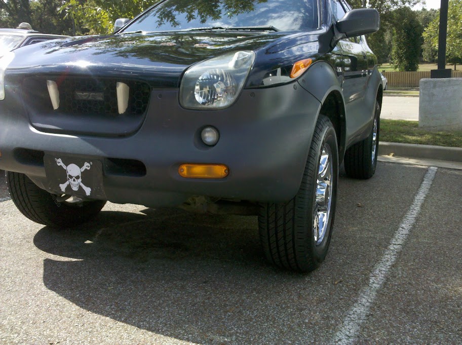

    Sorry it took me so long to reply. I ended up buying all four new... I got the michelin LTX A/S partly because they were on sale and my only other optionwas some off brand... I got them in 265/60 R18 will attach a pic when I get back to a computer... thanks for all the extra info as well everyone!!

    Looks alot better than with the stock sized tires I think...

    toast - Nice lookin' VX you got there!
