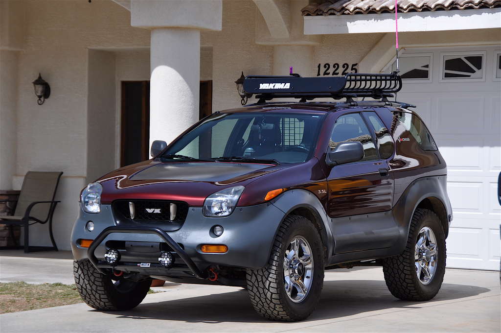

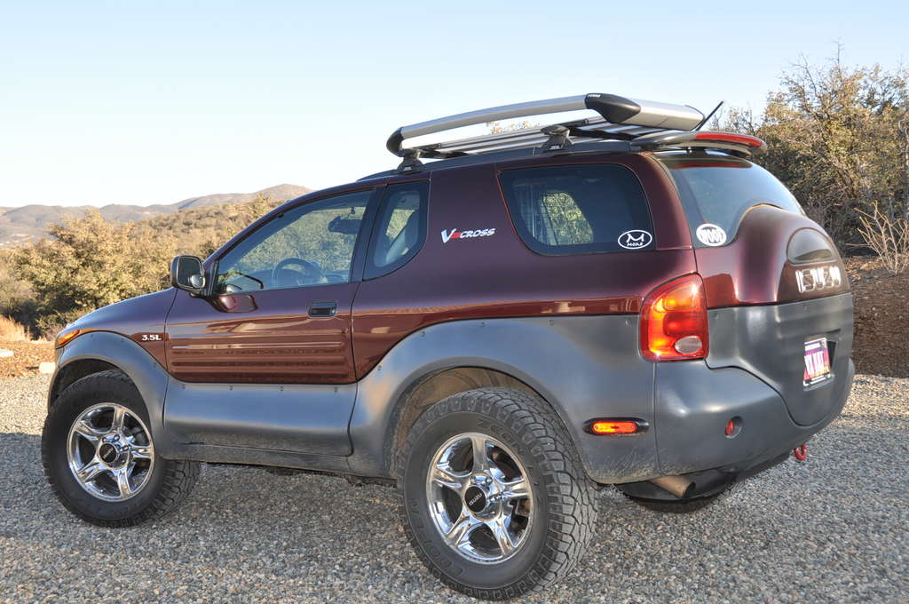

    And here's a shameless plug for Foxfire color:
    Jun 2009
    2000, Kaiser, #0016
    645
    Those are excellent pics Kat... guess I never perused your gallery before.
