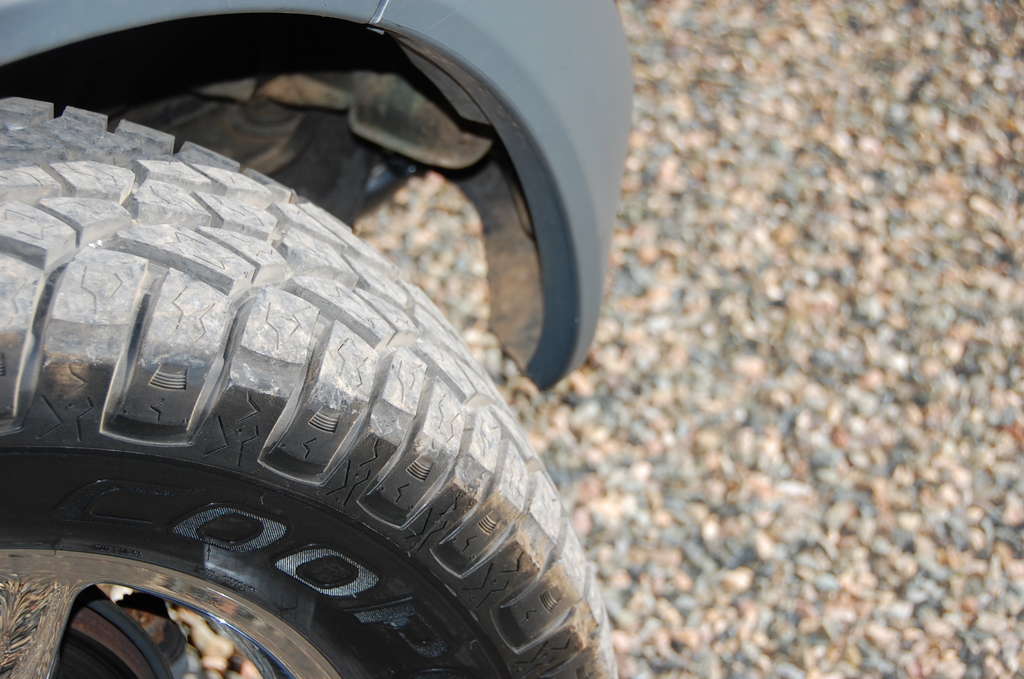

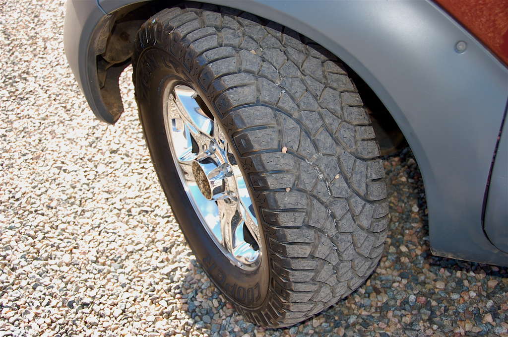

Ah, also I'm a bit concerned about putting bigger than stock tires -- if I go for a wider tire (285/60) how can I ensure the fitment so that I wouldn't have to trim cladding?

TRIMMING CLADDING TO FIT 285/60-18 TIRES ON OEM RIMS:
I have that size tire on OEM 18" rims, and NO TB cranked, and no lift, no special springs etc....and this is ALL you have to trim off cladding...it's very easy. Since these are hand made cars, we've heard several instances where people encounter slight variances and tolerances, so you may have a slightly larger or smaller piece to cut, etc... vt. mav said he had to trim cladding to a slightly different degree on each side for his tire/wheel application, so there's sometimes slight variances, but all very doable.
