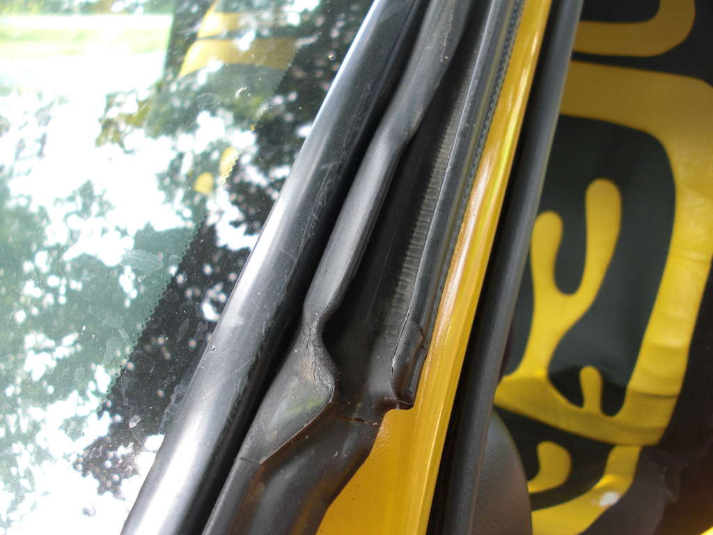

    Has anyone else experienced this?

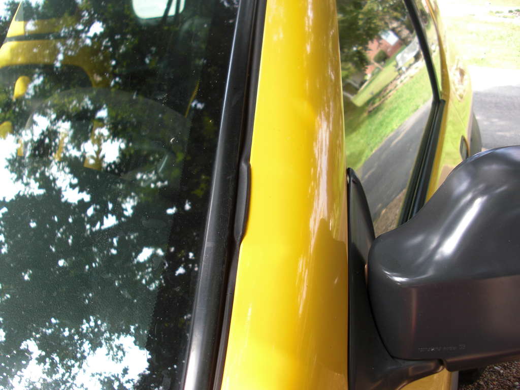

    It's been doing this all summer. I finally got so irritated pushing back down that I finally tacked it down with some weather strip adhesive. I'll let you know if it holds.
    Haven't had this happen on my VX, but all the doors are doing it on our Axiom. Frustrates the crap out of me too, you wash the car and get it looking nice then you look in your side view mirror and see this piece of rubber flapping in the wind.
    It didn't flap in the wind.
    It was just an irritant ... like a chronic wedgie.

    I have had that exact same thing happen glued it a fwew times that didnt work for long so I cut it off.

    It's NOT just a Proton thang! My left hand Drip Channel (??? Part #89725-10691 ???) also has issues - it separated at the leading front edge and the first 2" are missing. A previous owner tried to glue back what's left, but I have that leading, loose edge that "sticks it's tongue out at me" whenever the door is closed. At least that looks better than when the door is open - whatever was used to "fix" it looks like that tan, expanding foam insulation.
    I also thought about making it "go away" with an Exacto knife, but that would mean removing a few more inches of the rubber. I'll probably verify that it can be replaced (without financial pain) before I cut it off prior to my road trip this weekend. I'll use that trip as a test so I can see if the removed section turns out to be a big deal. If I don't get any extra wind noise or leaks, then I'll consider cutting off the bad part as "issue resolved."

    Just put a part order in to Merlin for the driver's DRIP CHANNEL rubber strip. Mine's ripped at the leading edge as well & my gluing attempts just look awful.
    $35.82 with discount, 6-8 week back order.
    OLD PART #8-97143-079-2
    NEW PART #8-9725-1069-1 (The one RickOKC posted)
    Merlin can find it by either number.

    Usually that happens from a sagging and/or misaligned door. Even just a couple mm can start causing that. Re-align your door if necessary and use a heat gun on the weatherstrip. Since it's a foam rubber, it won't be perfect, but should mold some.
    Avoid taping it.... it will most likely tear the stripping when you remove it.
    If the adhesive doesn't work, I'll check the alignment. If it's that critical tho, I'll prolly make it worse trying to make it better.
    I taped it but I used 'lectrical tape so it came off easy without damage.
