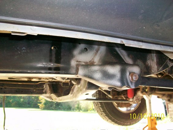

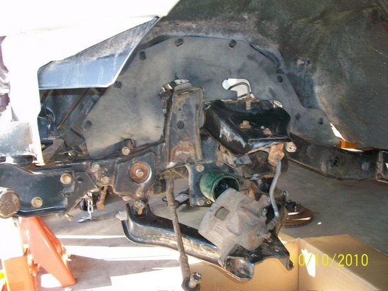

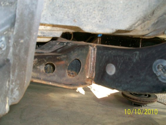

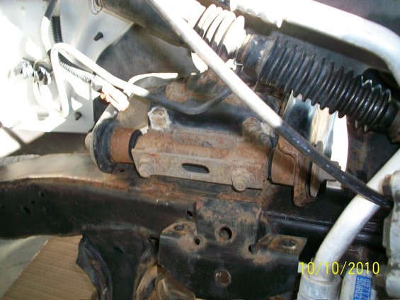

Rust, rust and more rust

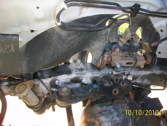

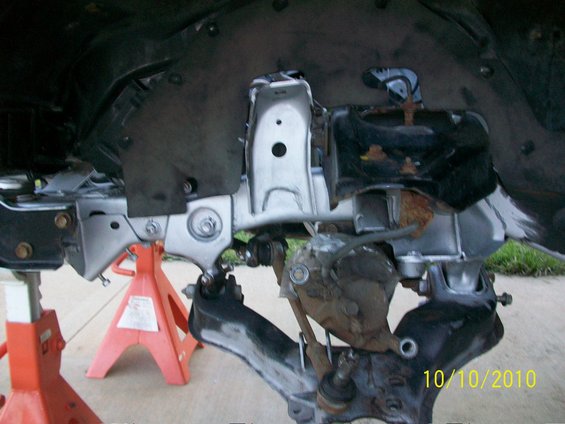

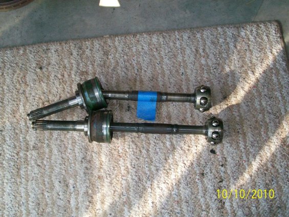

Axels and spindles....
Rusty rotors....

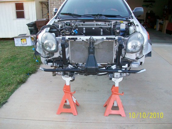

Using the new sandblaster..... makes life so much easier..... but a bit messy...

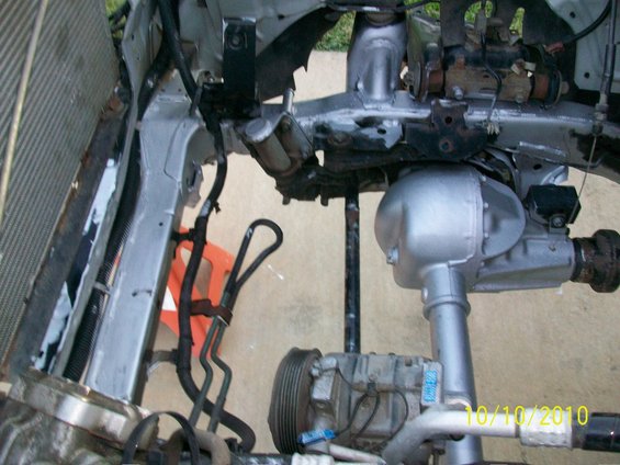

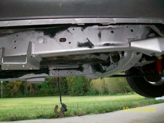

A little less rust.....
Applied the silver stage of master series coatings......
