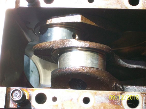

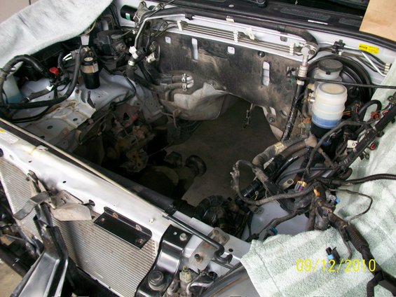

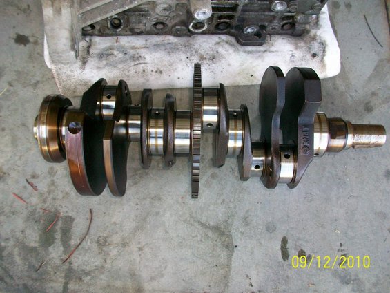

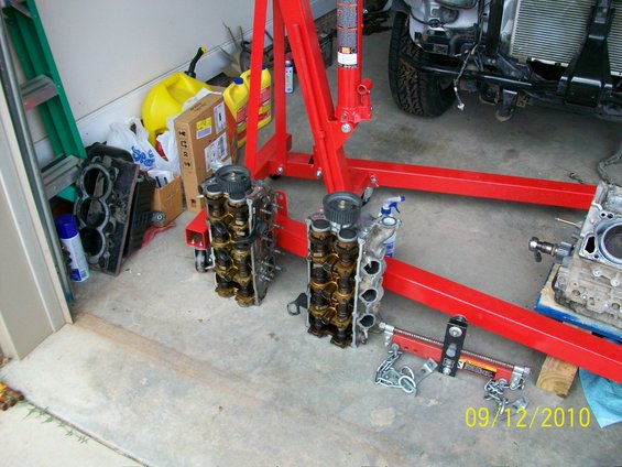

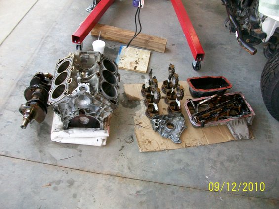

    Ok, got a little more done this week. The motor is out and disassembled. As was suspected the bearing on the front passenger side piston was spun and scored the crank. I am concerned I may be buying a new crank. I'll drop it all off to the machine shop tomorrow and get the final verdict. You can still see cross hatching in all the cylinders but the front cylinder on the drivers side has a scored place in it.
    Front passenger rod and bearings
    Oil rig stuck in groove, all pistons were this way
    Scored drivers side cylinder
    The crank
    The heads
    All ready for the machine shop

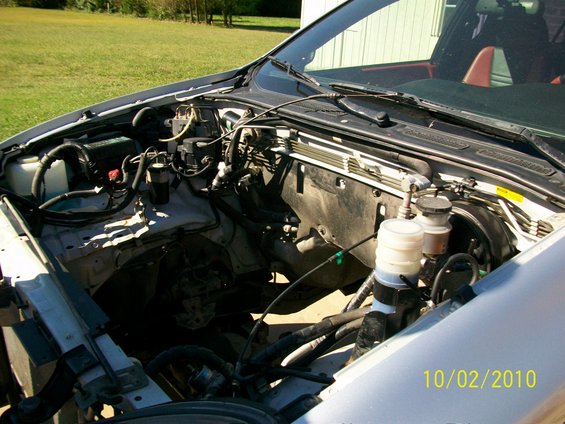

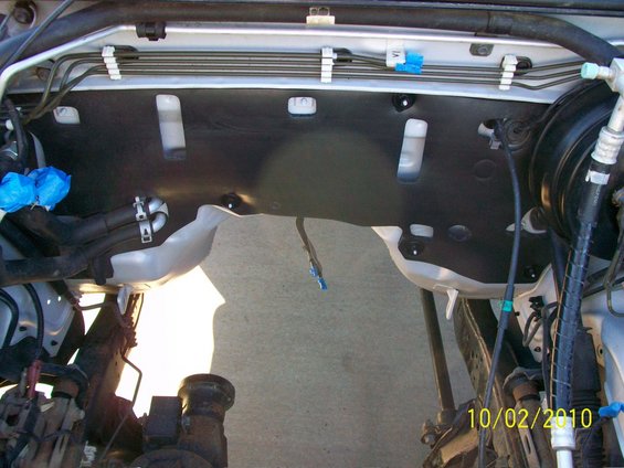

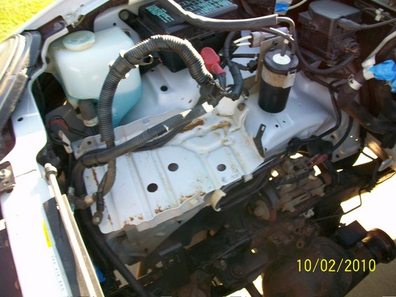

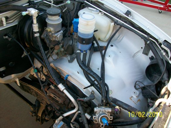

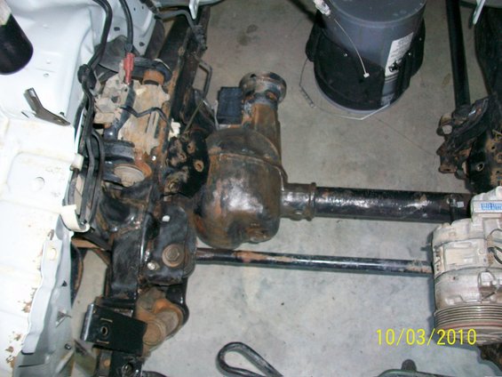

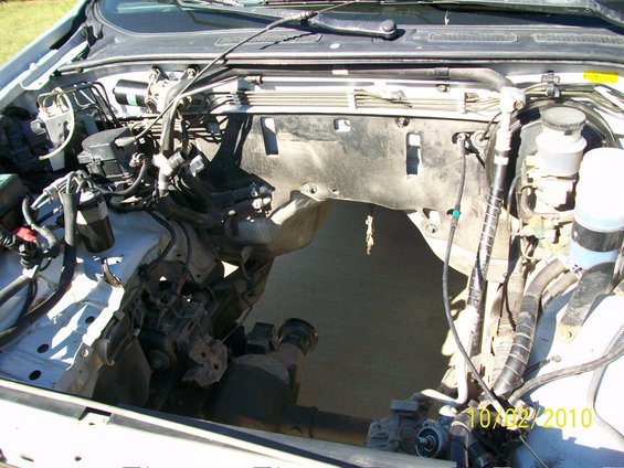

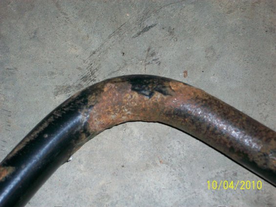

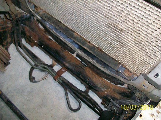

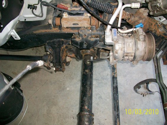

    Well the engine is at the machine shop, new crank has arrived and the tranny is out getting freshened up. While all that is happening, I am left to address rust and grime.
    Dirty engine bay:
    Preparing to blast the grime:
    Squeeky clean:
    Rust time:

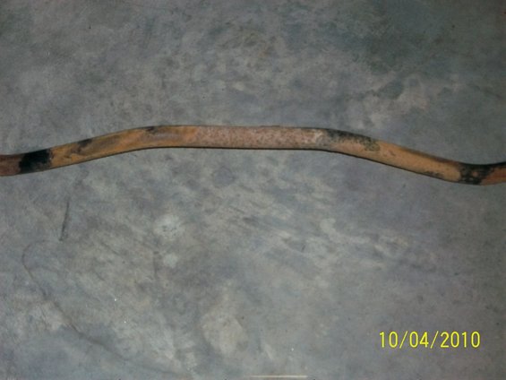

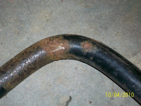

    A VERY rust rear sway bar:
    Front and rear bars:
    I am trying to decide now if I should replace sway bars or not.

    Sand and paint or powder coat? Would that stay on a bar that flexes like the sway bar?
    You've got some serious rust under the front end. Are you scuffing and rattle-can-ing or have some other fix in mind? I need to do this on mine. The front bumper bar is completely rusted out, and I need to get it out of my VX and do some sanding and painting.

    I am using Master Series Coating that RamAirZ turned me on to. The wife and I are sanding, grinding, scraping all the rust we can find. Once that is done we will apply the coating. It is some good stuff that will stop rust and prevent it from returning.
    CalMini sells new sway bars that are advertised as 40% stronger than stock but the price for the pair is 340.00. Kind of pricey but I have not priced OEM either. If I do not replace them I will take them to the powder coaters and let them blast and coat.
    If I'm looking at the right thing (stabilizer bar?) looks like they run $370 on IsuzuParts.com.
    Jun 2010
    1999, Silver, VX, 0401
    483
    Yea the rear stabilizer bar is the worse one of the two. It is heavily pitted in and around the bends es[pecially the outter ones. Just not sure if it has rusted enough to affect its strength. Was the $370.00 for each or both?
    Hold on it's actually worse, I just doubled the rear bar in the above estimate. Here are the actual prices each:
    Front: $219.93
    Rear: $184.42
    Total: $404.35

    CalMini is beginning to look better....
    Yeah at $339.95 a set they're over $60 cheaper, plus they boast 40% stiffer design. Zinc plating's got to be good for corrosion resistance as well. Wonder how much more harsh the ride would be though, especially with stock shocks.
    http://www.pureisuzu.com/sway_bars4.htm
