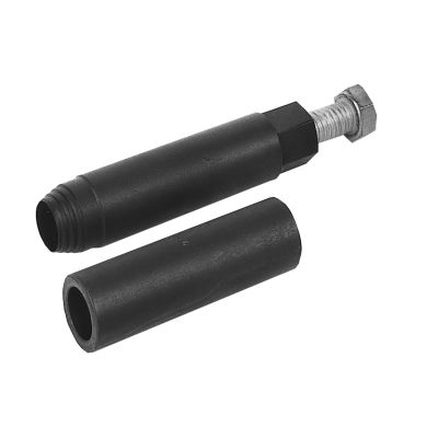

This is the tool for putting the seal back in and it helps to remove it too iirc.
I found mine on eBay for like $20 but Matco has it.
http://www.matcotools.com/Catalog/to...pe=T&cat=2238#

Apparently, it can be a little tricky! My regular shop tried twice and made the leak worse. I finally took it to a dedicated transmission shop and was told the seal wasn't put in right (had a "wrinkle") and all of the old seal wasn't completely removed.
Mark is absolutely right, you need that tool to get the whole seal out!!
Sounds like one of those tools we need to keep in the "member toolbox" to be passed around as required (like the modified wrench for the FPR.) I really doubt you'll be using more than once (unless your name is deermagnet!)
