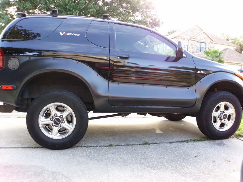

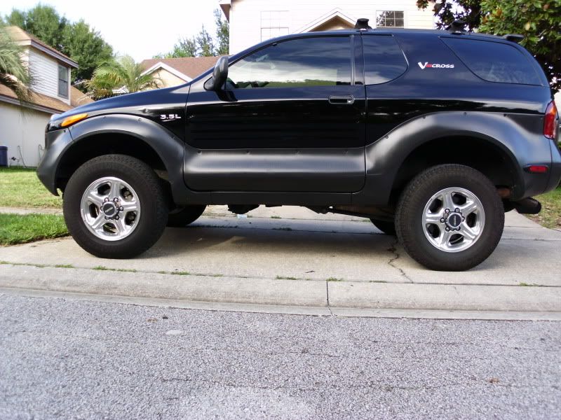

    I finally got the OME 912's in today after I got home from work. Got to work right away in the garage, and I'm proud to say it only took me about an hour to get the springs in. In fact it took me longer to drive to the parts store to get a 27mm wrench and drive back and raise the front torsion bars!

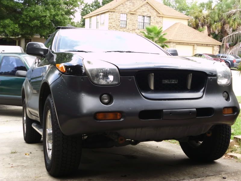

    I didn't take any good before pictures, but here's a couple that I took of the truck when I got it home a few weeks ago.

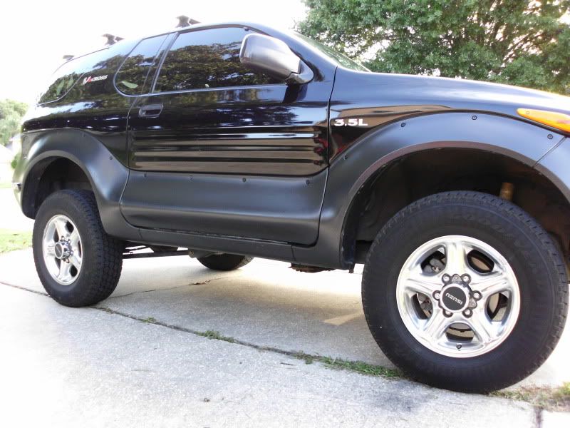

    And here is the after shots I took in the drive way
    I think I need to raise the front some more, maybe an inch or less.
    And since I can't afford a new MS ECU for the SVO and a new set of rims and tires for the VX I think I'm going to go ahead and get the stock 16" wheels powder coated and mount some nice tires on those.
    I measured the front gap at 6 3/8th inches on both sides. I'll take it to get aligned this weekend when I pull the rotors and get them turned.
    Nice job, Bob. In the last pic, your VX looks just about right. I think I turned my t-bars about 8 times each, and I think my VX has a very slight rake. The less you raise the front, the less stress on your CVs. Just keep that in mind.
