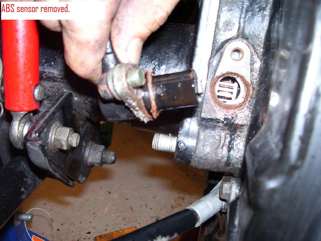

    Here are some photos from my gallery that have some shots of the Swordy Sway Bar Disconnects. They are so simple looking I almost feel like it would be easiest just to make your own or have them made. The red shaft is a hollow pipe with holes drilled in it for the removable pins that hold everything together when you want sway bars in tact.
    Left side of the picture:
