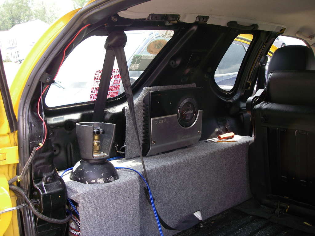

    Good point Marlin, here's a pic of what it would look like in your rear door, courtesy of Bart (nfpgasmask).
    Super clean IMHO.
    Btw, the starter/compressor that I got would definitely fit in the rear tire area. Imagine this in the pic above:
