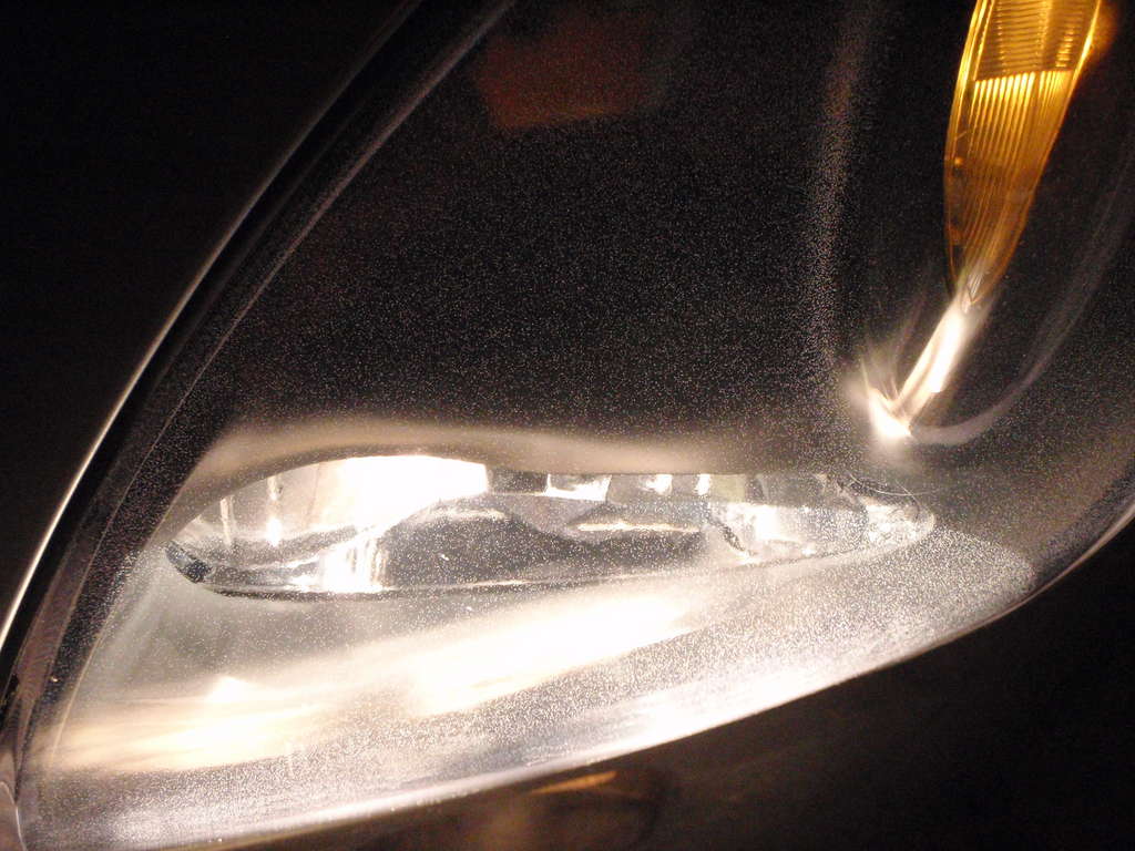

Photo #1 (sorry i have a horrible camera and this was at night)
Photo#2
If I had something other than a crappy camera phone you could see they are crystal clear!!! Hope this helps.
