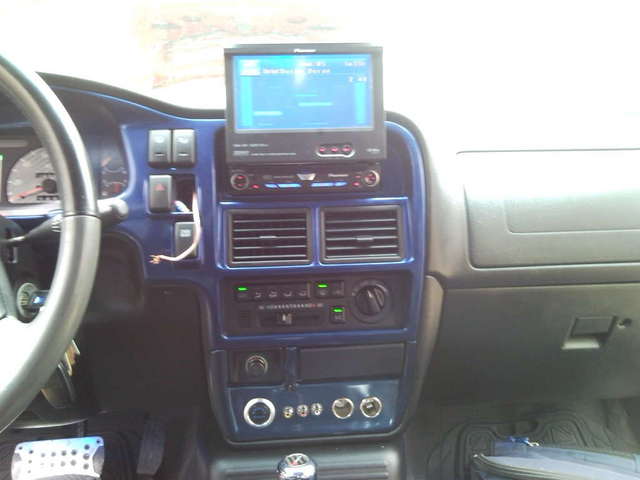

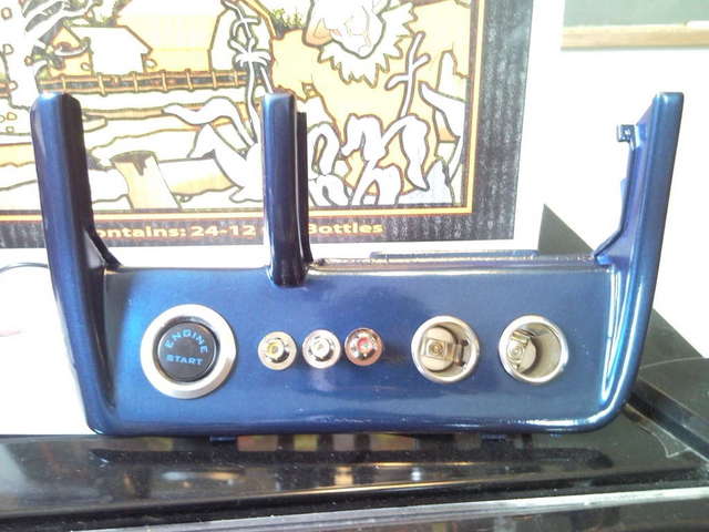

						well, I installed two power outlets where the ashtray went. But now with the Jensen unit I bought from 'twistedsymphony, will be doing a redsign and moving it along with the MediaLink3 interface to the lower DIN location
That looks pretty good where did you wire the power from?
direct to the battery. ran a 10ga power wire with a fuse, then split it between the two outlets. ran the ground to under the center console.
that way i can use the outlets even with the key out. like if my phone is dead, ill run into a store and leave the phone charging.. also comes in handy for air compressors and spot lights

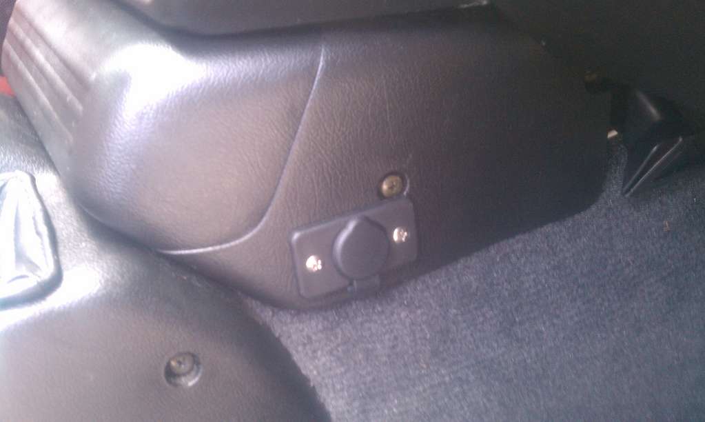

i went to walmart and picked up a marine outlet for 5 bucks, and an 30 minutes later here it is, i wired it atraight to the battery.
						Looks nice!
