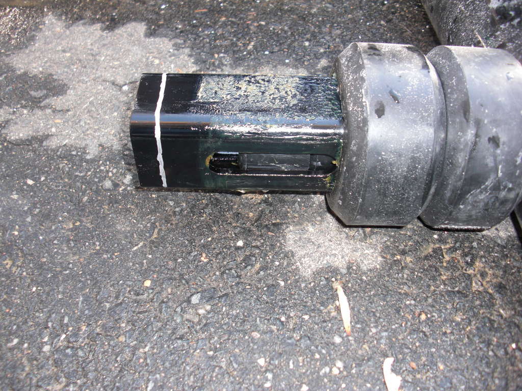

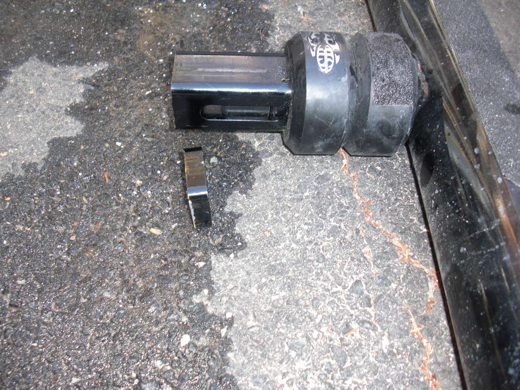

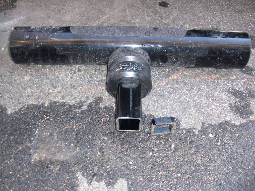

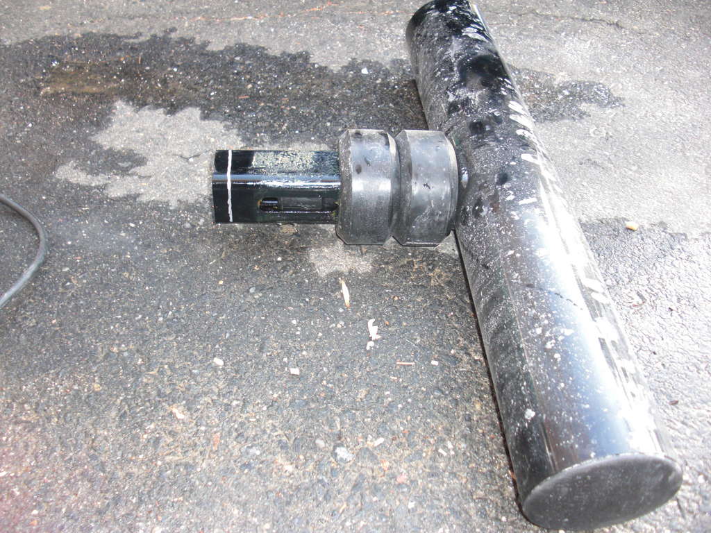

						Ok, earlier I mentioned that the dimention of the SuperBumper compressed exactly equals the distance from the pin to the fuel tank shield. I didn't want to take any chances that the tube would puncture the fuel tank in the event of an accident so I removed 1/2 inch from the end of the square tube on the SuperBumper.

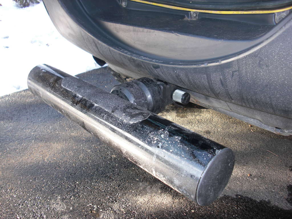

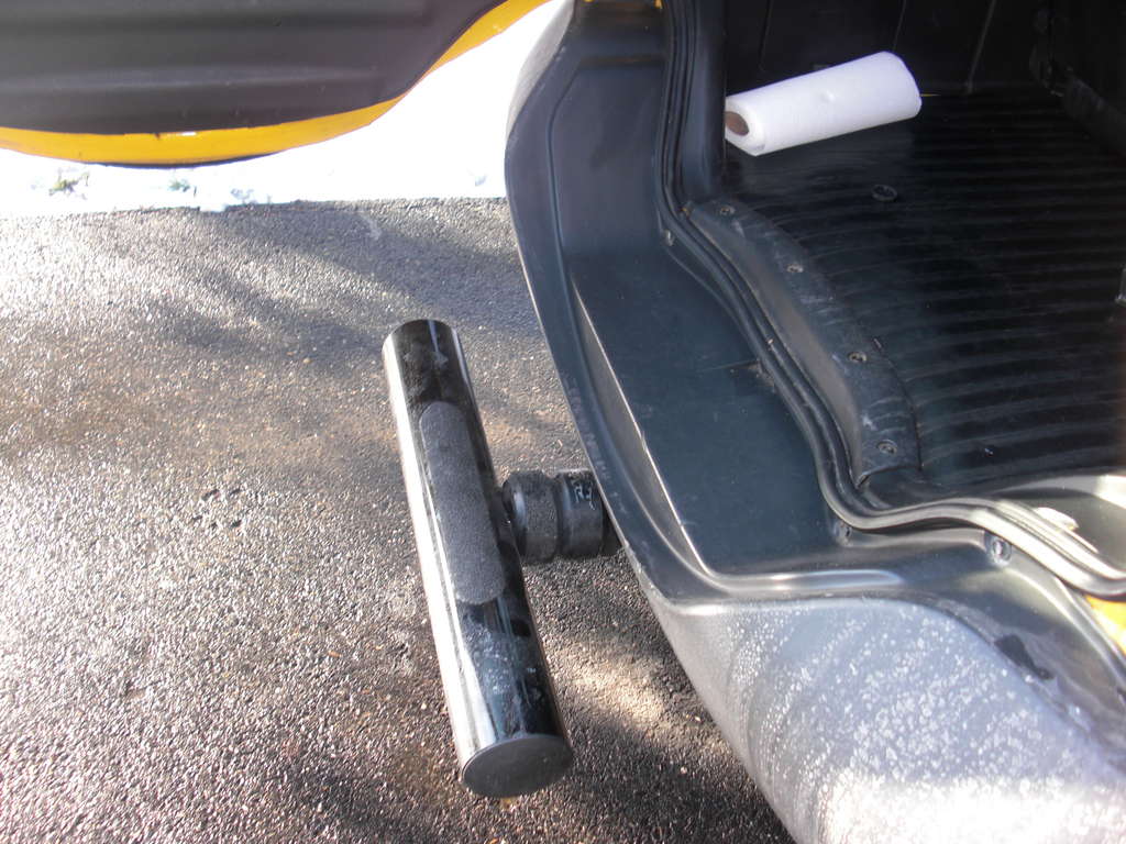

Can you use it as a step: ABSOLOOOOOOTLY!!!
I figure there's better than 400lbs on it in that last pic.
						Looks like that Gen-U-Whine Tone receiver could use a drop or 2 of paint.
The bumperette looks good though.
