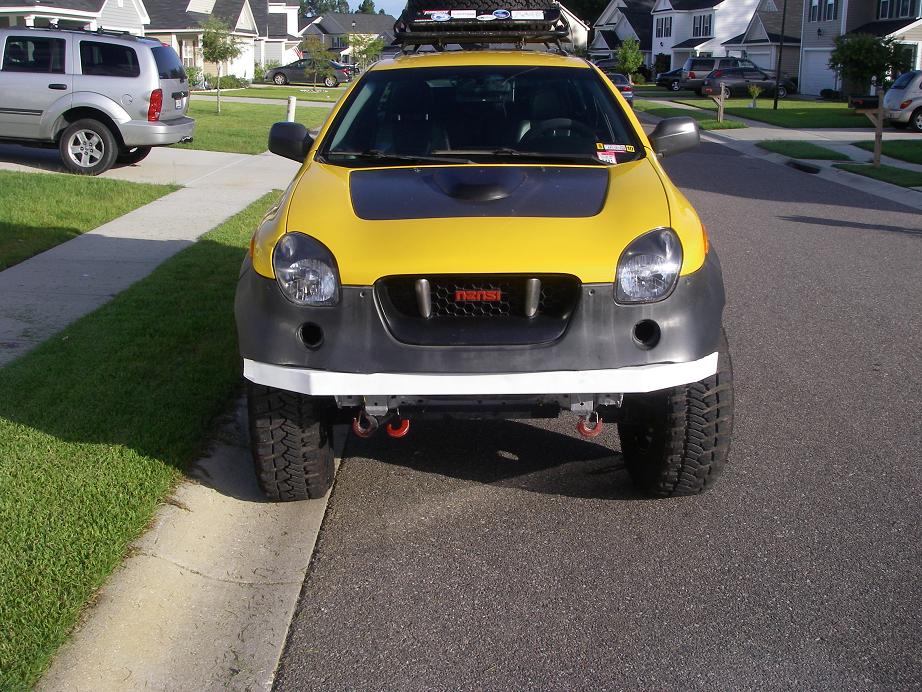

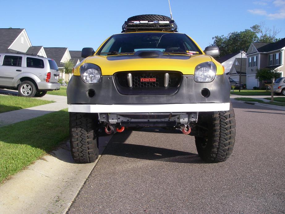

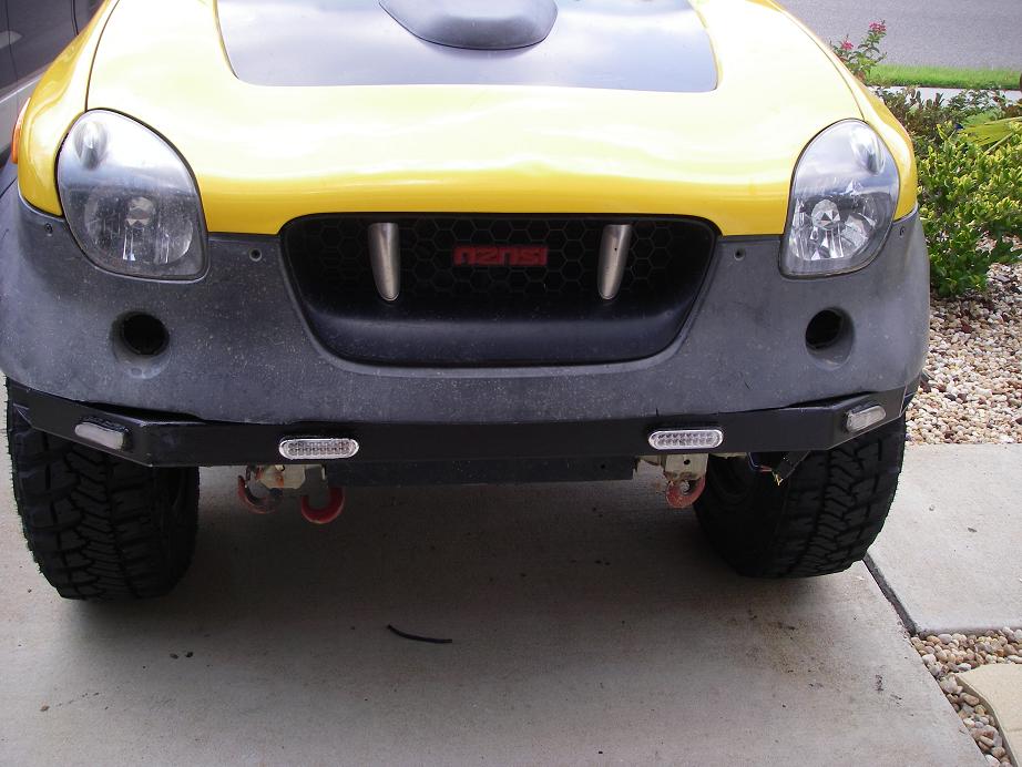

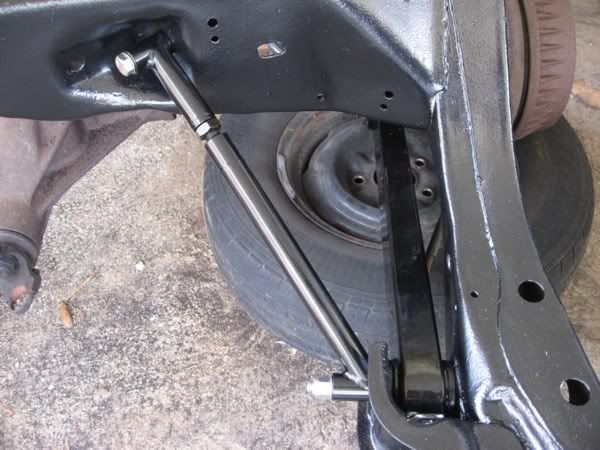

    I have it all welded and mounted. I still have to do the end caps, but I can't do that till my LED lights come in from Hong Kong. White LED running lights, and turn signals. So its all primered, looks funny white, but its starting to grow on me. I POR 15ed the front frame rail and crossmember. Neat stuff. I am speckled silver, white and ceramic red. It took a few hours to do it, but that stuff is no joke. It dries rock hard, and goes on super easy. Its very thin until it dries.
    Once its all wired up, I will weld on the end caps, and rhino line the bumper and front cladding, and pending how that goes, may end up doing all of the cladding.
    This bumper is much more boring looking. But now I can build a skid plate for it...

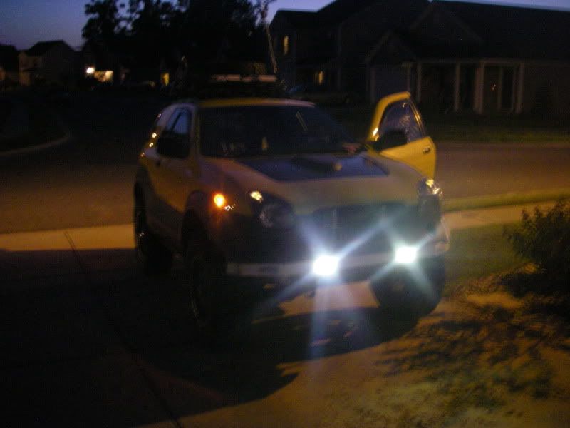

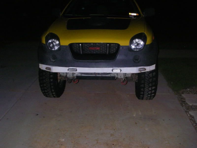

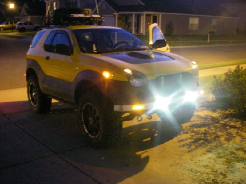

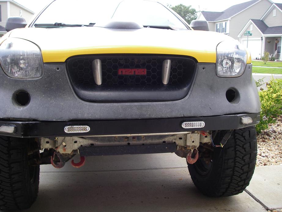

    Finally got all the lights wired up and mounted. PITA to cut holes through that tubing for the LEDs. I used Jack's idea (PBkid) and used hitch wiring connectors for connecting the lights, that way it is easy to take off. I even lowered my headlights down a bit, when I was blinding guys in lifted trucks, I figured I needed to do something.
    I called Herculiner to see if it would bond on RTV. They said yes, but not as well as metal, then I asked about acrylic glue gun glue, they had to call me back on that, but they said yes, better than it would RTV since it dries hard. So, I used the wifey's glue gun, and sealed all the lights up, better than epoxy or RTV, and I was able to trim it to look nice. I will post some night time pics this evening of the new lighting. Still need to fit some lights into the drive light housings. That will be later on. I also need to mount up a skid plate, I got a dent in the oil pan last trip. Can't believe that is the lowest part in the front of the truck, and there is nothing in front of it...silly design.
    I will try and get it painted next weekend, but I am making a junkyard run on Sat, so that is one whole day gone. Gonna get some more switches, and parts for the new family member thats coming in a month or so (93 trooper RS), thread to follow on that.
    01, LineX tan/black, 1055
    3,380
    Here are the pics and a few videos:
    http://www.youtube.com/watch?v=G41meg8-HCE
    http://www.youtube.com/watch?v=v9QQgPZfx-Q
    This pic came out kind of neat, first time I used the night setting on the camera. You can see that its dark in the other pics, but in this one, it looks daylight.

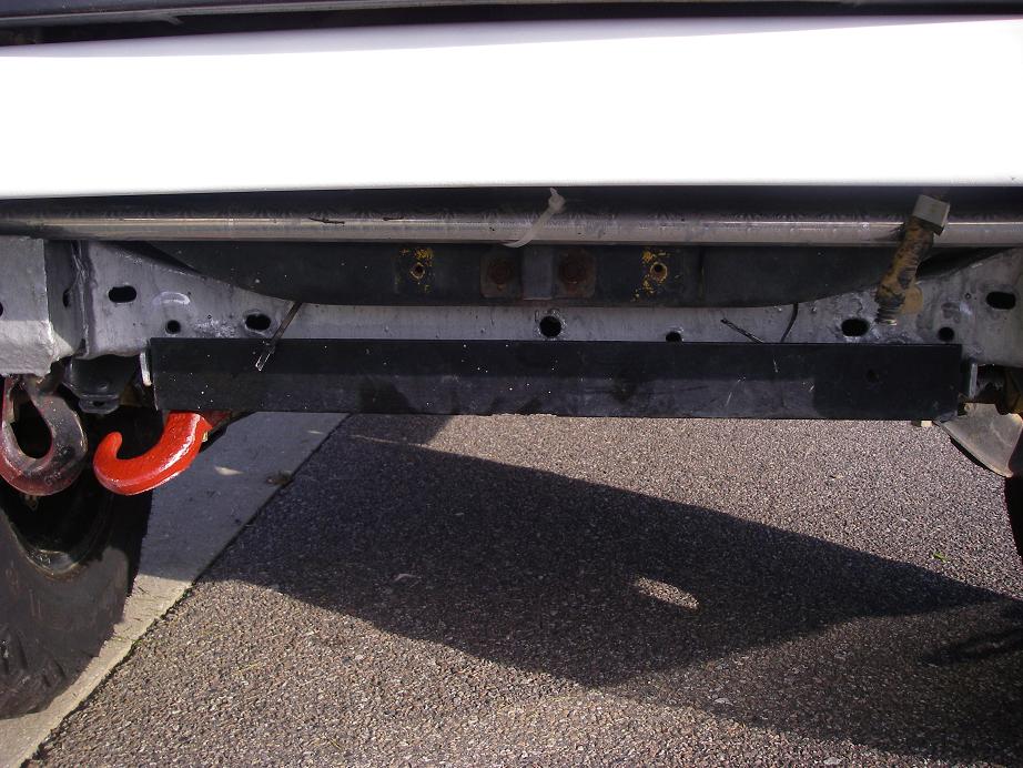

    Yeah, now its just kind of boring. I think my last one was functionally superior to this one. Orion's style, does not help on steep approaches. The frame rails now stick out further than the bumper brackets, making them the first thing to contact rock. Not a good idea. That is why I have to fab up that cross bar. It will protect the frame rail ends and distribute the contact force over a larger area.

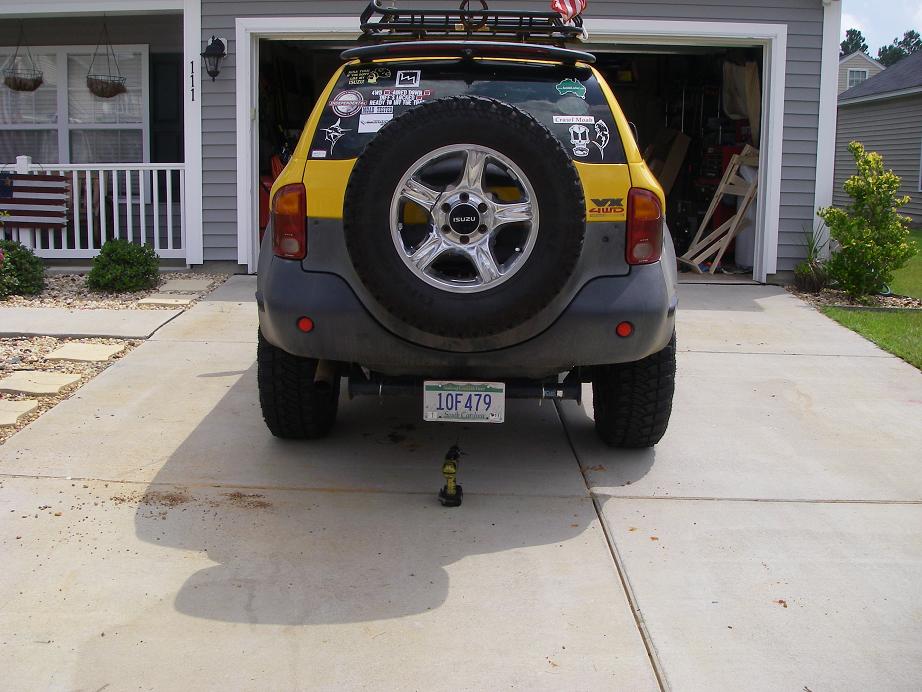

    Skid plate idea on hold, in my typical fashion, I got under there, pulled the cross member down, cursed a bit at all the dirt falling in my eyes and mouth. Then I noticed the heat shield forward of the cat was rusted and I thought viola, thats whats been rattling. Screwed around with that, problem solved. Then I noticed one my transfer case bolts were loose, tightened that, and the checked all of em. Then I noticed that my rear drive shaft U joint was missing a bolt!! Not sure how long that his been gone? So then I dug around the garage to find one that fit, weird size, the bolt head is not much larger than the threads,so I need to go to the store...then I thought about how to mount my license plate since it isn't visible under the spare. See where this is going? I spent two hours fiddling around with stuff that I had no intention of doing. Then I took a look at the brake lines to see how hard that job was going to be since I still have yet to install my pretty SS red lines
    Long story short, I built a hitch adapter to hold my license plate. Red paint is drying as we speak Put cross member back on, noticed a drip of tranny fluid on the drain bolt, but no marks in driveway, so it must be a very slow drip. No wworries there. Now its too hot to get anything else done. SO maybe next weekend, but I am supposed to go to junkyard to get all the parts folks have been asking about and some more switches.
    3,380
    Here is the finished license plate project, I have been driving around since last year with the plate covered, no problems, I suppose it was just a matter of time.
    Here are some painted bumper pics as well.

    So, how many offroad trips you think it will take before the plate gets ripped from that location?
    Also might want to check local laws, but most states require a plate light.
    3,380
    I think the plate will be fine. 1/4 angle iron isnt goin anywhere, as for the lights, well, over a year with no plate, I figure I will be ok without a light. I rarely drive at night anyway.
    2001, Dragon Green, 1342
    2,393
    Just be careful IF you ever have one to many at the club and am driving home at night, that's the time the man will pull you over for it. No sense ruining a good career.
    3,380
    Mybad, I misinterpreted your comment, you meant the license plate, not the skid plate. No, the plate goes to factory spot when I wheel. I move the spare to the roof on the trails just in case a steep ascent.
