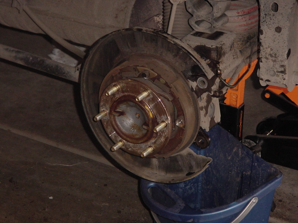

    Apr 2004
    2000, Ebony, VX, 0370
    2,503
    Thanked: 12
    Yep, take a look at the image below of my disassembled rear brakes (during my last brake job). What looks like drum brake shoes (the curved pads) are actually our e-brake.
    Hope that helps.
