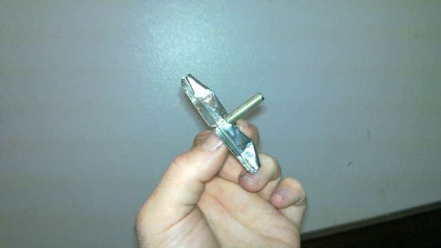

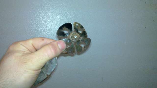

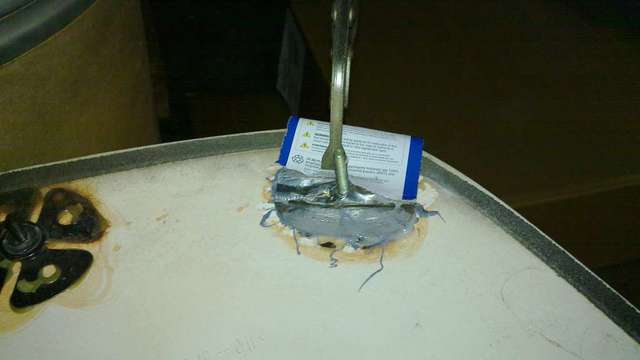

    First Thing I wanted to do was clean the drain ports under the hood insert. Two of the mounts broke.
    So I made news ones
    And bonded them into place.

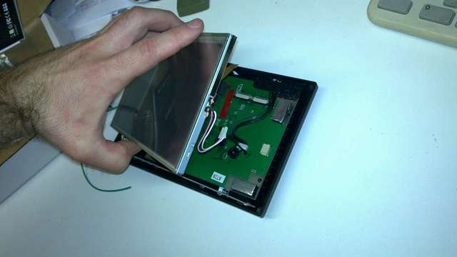

    Then I was thinking that the stereo isn't really that great. I saw another member put an LCD in his dash and thought it was pretty cool so I gave it a go. I wanted a big LCD though so I got a lilliput 8" wide sreen. Then took it apart.

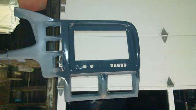

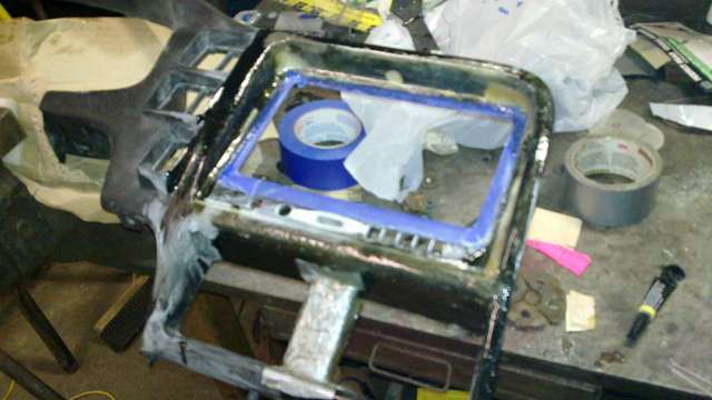

    Then I cut a hole in my dash and test fit the LCD Bezel
    The directions on the can said to dab on some resin with a paint brush then apply the fiberglass.

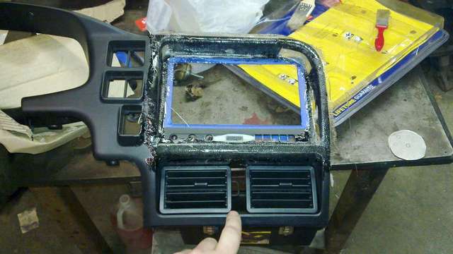

    While this first layer was curing I realized I like the center vents on the car and decided not to block them off. So I put the vents one slot down and started making a foam bridge for between them.
    I then wrapped the foam in foil to make sure it didn't melt from the resin.

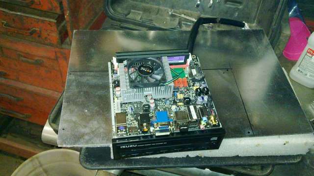

    Between waiting for layers of fiberglass to cure I decide to sort out the computer and stereo situation. I purchased a mini-itx board with nvidia ion graphics power. I thought the small size would be beneficial but it was even better than expected. I also got a GPS sensor, infrared lamps for the bumper, nightvision camera, uniden bearcat police scanner, Centrafuse 3.0 software and a complete 2000w stereo system. Everything came together nicely, the IR lamps are even the perfect size.
    So I mentioned the mini-itx board was the right size. Here is the height
    and footprint.

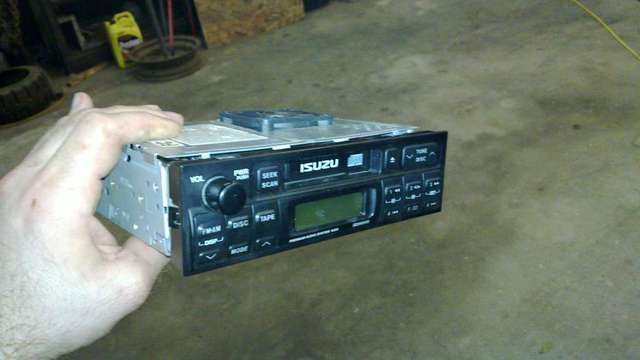

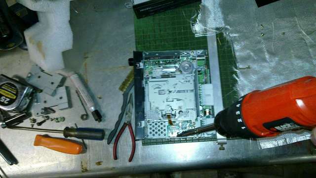

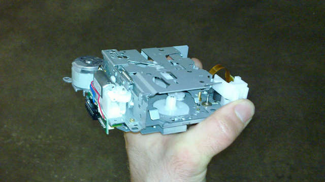

    stock stereo case to house the computer rather than make my own. I found some good parts in the process I will reuse later to automate the lid on a special compartment.
    Yeah buddy!
    Cut a hole in the top for the fan and its done.
    I can even put the face back on but it will be off since it will be behind the LCD.
    Test fit

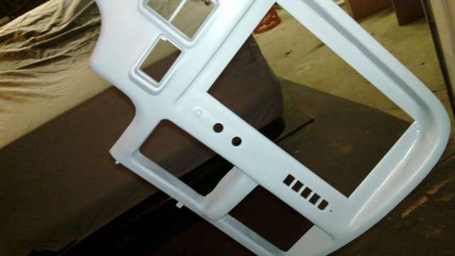

    So now a few more rounds of painting, sanding, and filling holes from air bubbles.
