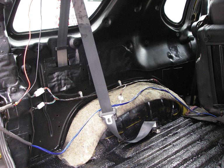

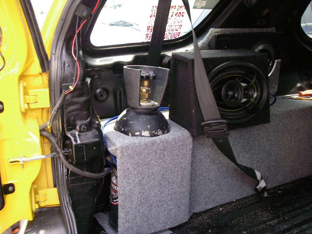

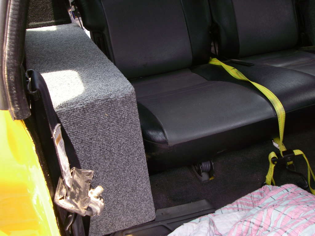

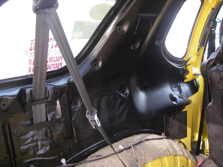

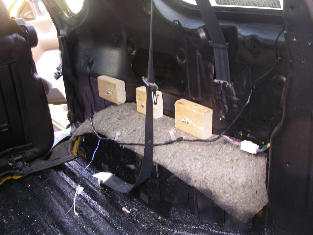

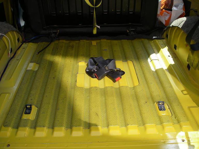

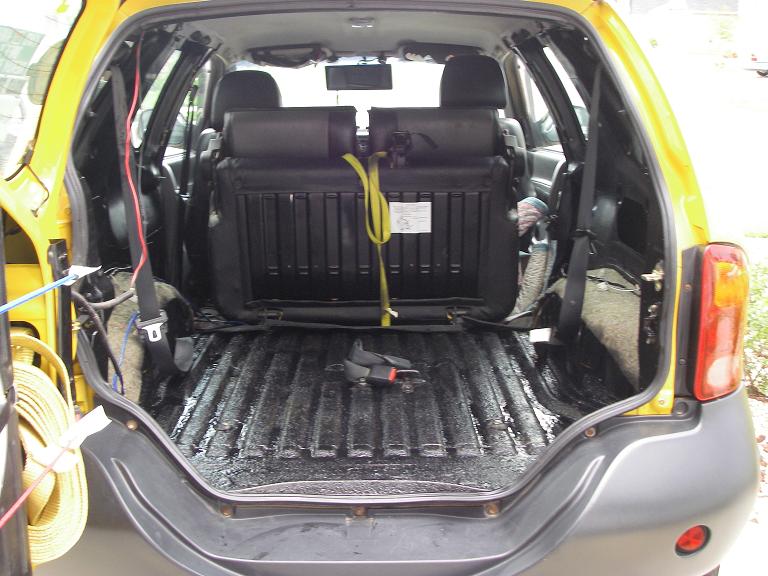

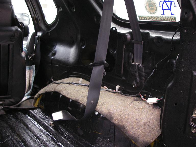

    Well, I had been daydreaming about Kenny's project all week. The wife gave the go ahead as our 9th anniversary present. I gutted all the plastic out this morning, about 1hr. I then cleaned out all the crevices and Moab dust. (I feel your pain Bart, I can't even imagine doing the whole truck, but I am getting there). I got out the angle grinder and removed the factory jack mount. I now realize how much room is wasted with all that plastic. You can see how big the gap is between the rear seats and the body. Before I could only snug my CO2 bottle in there, now there is a ton of room. So I picked up a quart of rustoleum undercoat for the sides and a quart of herculiner for the floor. The ultimate goal is for this to be lightly hoseable. The rustoleum covers amazingly well, and you get a nice buzz while in there painting, even with a fan on and windows down. It dries hard to the touch in about 30 minutes and covered the yellow completely in once coat. I will finish other side tomorrow and the floor as well. I will add some cargo tie downs to the side and floor. Next up will be the wheel well covers. I will do similar to Kenny, only leave cubby holes in the rear and front, one for CO2 bottle, one for tow straps/first aid....In the front I will drill out a few holes and put in cup holders. That should give me a ton more convenient storage. The rear seats will be staying in. Its not that bad once painted. I need to get some flex conduit, rerun all the wiring, add some side mounted lights, mount the amp, and voila, a much more useable rear cargo space. This project should cost me less than 100 bucks total. The two cans were about 40 bucks together. I figure some treated plywood or perhaps masonite for the fender covers, I will herculine that as well. I will get some LED lights for the sides. This is a pretty fun project so far. Instant gratification kind of thing. The only thing that will cost me will be some 6x9s and some boxes. I will mount those high, similar to Ldub(IIRC) did in his.

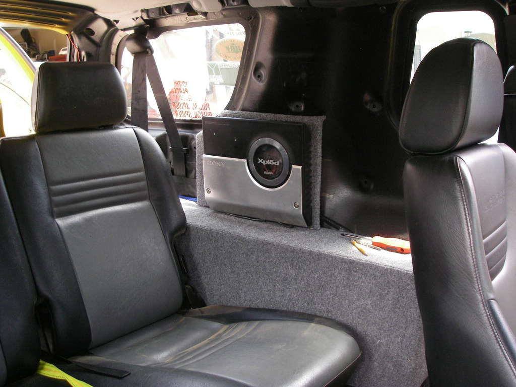

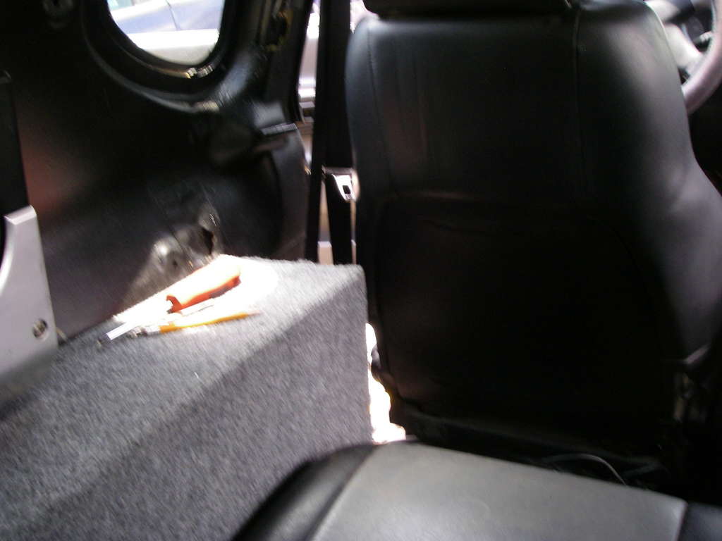

    Day two of the what my wife calls the "waste of time" project. I got the sides done and the floor rhinolined. I will move the amp and do the storage portion tomorrow and hopefully be done. Then I will do my overhead console. That should be interesting. I have touch up to do with the undercarriage coating.

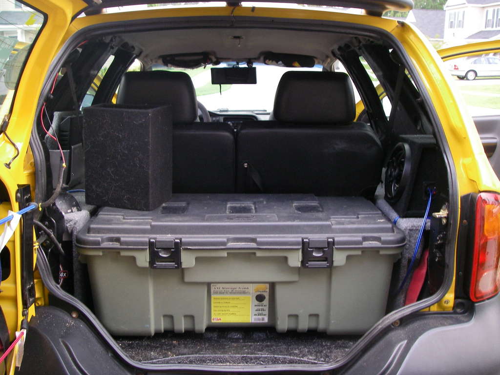

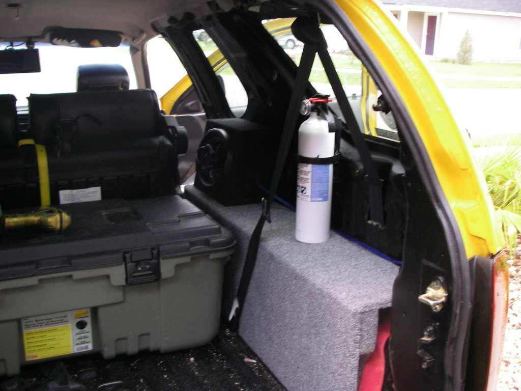

    I just got back from Harbor Freight. That place is the devil. I got some of the nite eyes caribiners. They fit the holes in the overhead perfect. I hung up the tow strap, flashlights, air hose for the CO2 bottle. The 6x9s are in their final resting place. Now all I need to do is hit the yards and get some factory drink holders for the arm rests. Too hot to work today. Gonna play some Final Fantasy XIII. Yippee for fathers day!
    I also picked up a small 3gal air compressor for 39 bucks. Good deal. They also had a 900watt generator for under 100 bucks. I did some research, only bad reviews I could find is that you have to replace the Chinese spark plug with a good one, and it is loud like a weed eater. It would be awesome for junkyarding. Then you could bring electric drill and impact wrench, sawzall...If I could find a place to mount that, then I would be zombie revolution prepared!!!!
