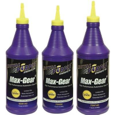

    I use Royal Purple MAX-GEAR 75W140 (no lsd needed)
