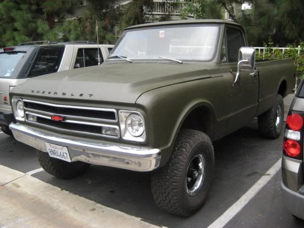

    Ya the GMC grille's look more "finished", I always felt the Chevy grille's were lacking in the style department. Except for my 68' K10, I LOVED that grille:
