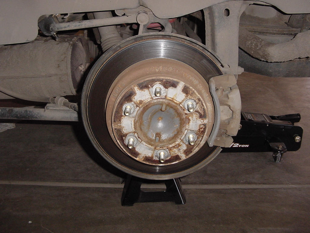

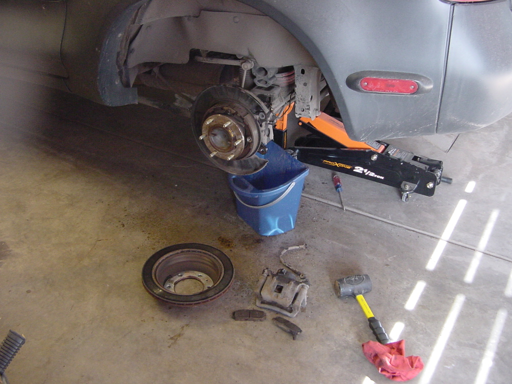

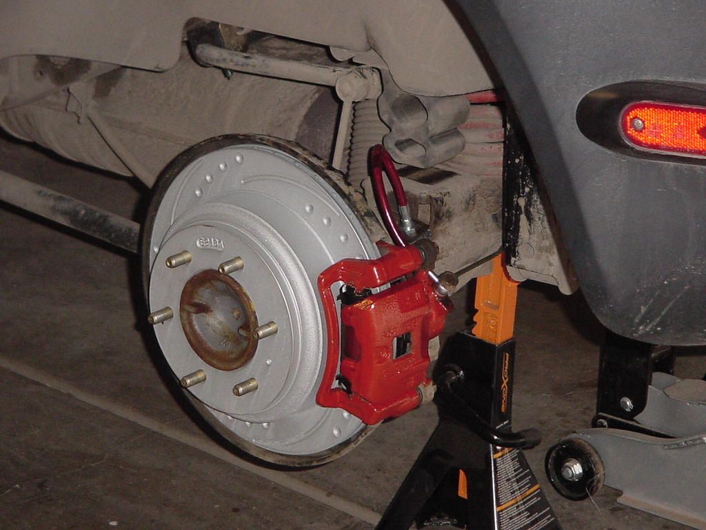

    Here are a few shots from my brake job a couple of years ago:
    Stock rear brake assembly.
    Stock assembly disassembled.

    New rotor, painted caliper and braided lines. You can really see where the rotor sits around the end of the axle here.
