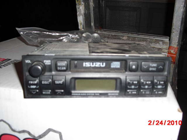

How do you change the time on an OEM VX radio?

						I believe you hold down the AM/FM button while pressing the 1 or 2 buttons (they're labeled with H and M for hours and minutes). Don't take that to the bank though, the previous owner actually wrote the clock change page # on the outside of my manual out of frustration.
						The instructions above are correct.

						Hold down 4 key until it beeps to make the time come on while running the stereo.
						On mine, when it's showing station info all the time, press and hold the AM/FM button for two seconds and the time will show for a few seconds and then it goes back to the station number.
To change it to show time always, hold down the AM/FM button and then hold down the #4 button for six seconds and it will change to time always after the beep. Do the same thing to change back to stations always.
