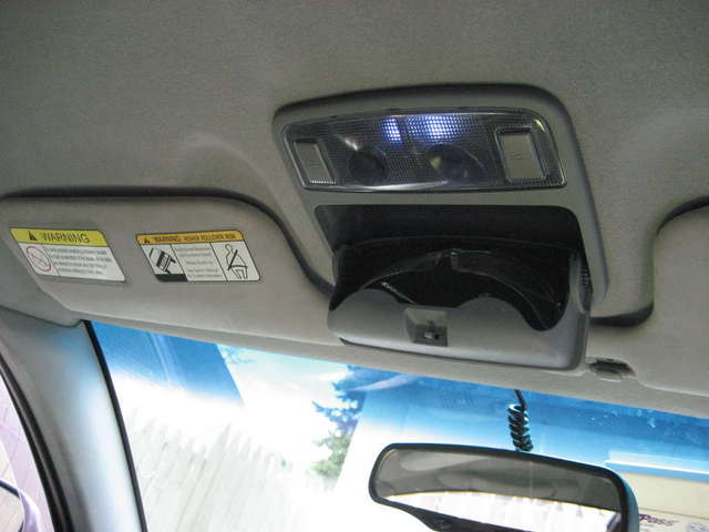

overhead console with 2 map lights and a storage compartment
I pulled it from a 2003 hyundai elantra (SHHH! dont tell anyone!)
it was not a great fit at first, theres a roof support beam across the top of the windshield that prevented it from fitting all the way which scared the crap out of me, since id already cut a monster hole in my headliner
after some trimming of the console, it is a very nice fit, anyone looking to do this mod, make sure to mount it as far towards the back of the VX as possible to minimize interference from that beam

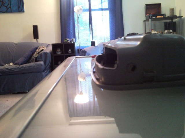

heres what i had to cut off the console

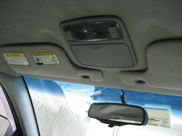

and heres how it fit, you can see the beam with some dynamat on it up there
i also ended up shaving down the top of the console a bit too, to eliminate any touching of the roof
