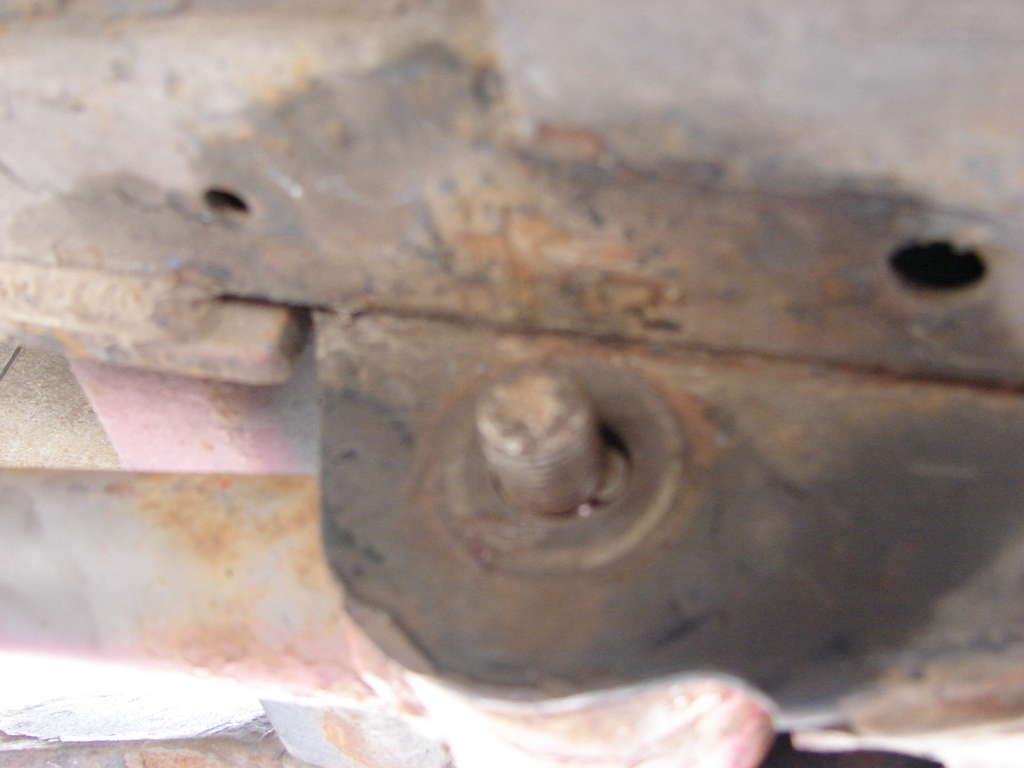

    I'm definitely in need of this fix. Do you think you can post a pic or two?

    Quote Originally Posted by phines View Post
    Sorry it's not a better pic, it was getting close to bedtime & my cameras batterys wen go
    I had to button her up & hit the sheets.
    This is one of the 1/2 moon keys in place before the washers & nut go on.
    I'll try to do better before & after welder dude does the zappy-zap...

    That's perfect. I know exactly what you're talking about now. Thanks!

    Hey Dub, I'm about to rip out my mounts to install the new rear suspension. If you want them I can send 'em out to you for the cost of shipping(probably $5-8). As far as I know they are in perfect shape. I can send pics if you want them. Just thinking you could have them welded on just as easily.

    Did you SEE the pics?, does YOUR hole look like mine?...
    C'mon dude...get a wrench & SEE what's going on...
