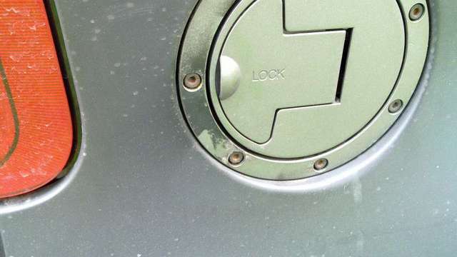

    What could this be? The seller had no idea.
    it looks like a gas cap to me
    Looks like a little paint overspray to me, although why it would be in that particular location doesn't make sense...

    Quote Originally Posted by BigSwede View Post
    My thoughts exactly. I will definitely be refinishing the filler cap.

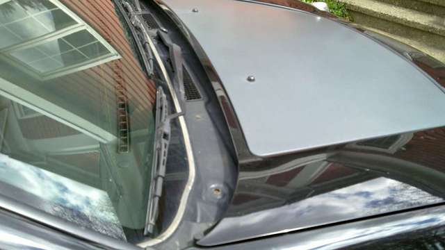

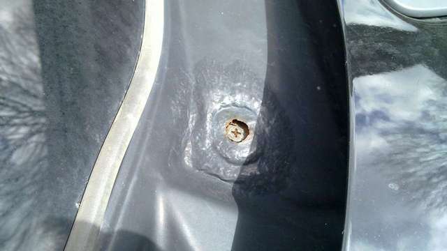

    I just took another photo of the rust.
    Is it possible to replace this part in front of the windshield?
    Maybe fix it like this...
    http://www.vehicross.info/forums/sho...ight=fuel+door
    And replace the cap screws with new stainless hardware...

    • The gas cap allen bolts are rusted, just as yours are.
    • My gas cap and all body panels have light over spray from where the previous owner rattle can spray painted all of the cladding and hood insert. It looks very similar to your gas cap.
    I ended up cleaning up most all of the over spray on the body and gas cap with a little bit of carefully applied paint thinner and Meguiar's rubbing compound. I then buffed and waxed the cap (removed from car) and the body. It looks great now. I also replaced all the allen bolts.
