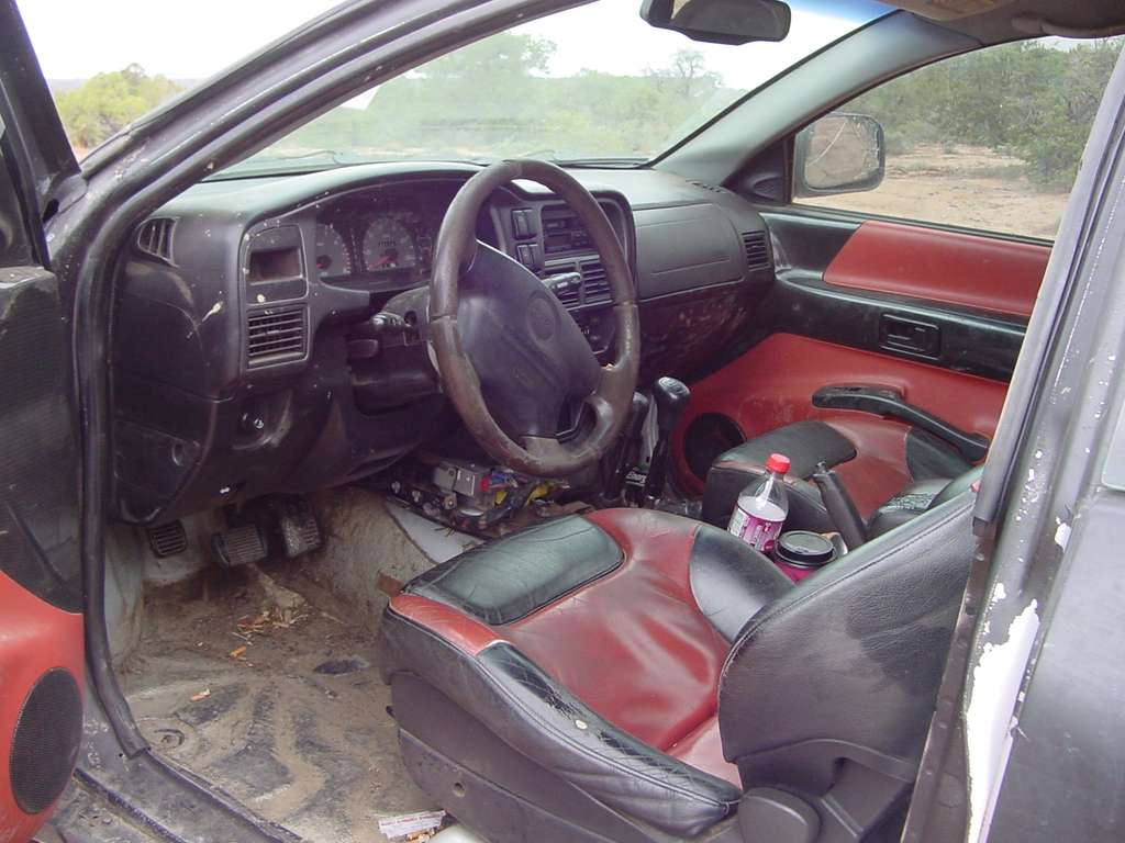

Remove your old auto and transfer case, T. Converter, flexplate, pilot bushing from crank, and drivelines, exhaust, computer, shifter assembly...ect...

Driving the manual trannied VX is AWESOME!!! More controll, power.
Power and shifting seems VERY similar to a 90s era 5.0lt 225HP mustang!!! VERY FUN! 0-60 times has surely dropped.
Everything feels more "DIRECT"...
The TOD functions just as it did with the AUTO...
