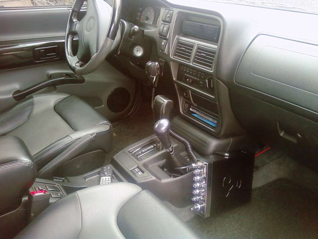

The full in cab install.
Couple of shots of the CB unit mount. I used the one screw that holds the trim piece around the shifter to mount the CB mount. I had to drill a new hole in the mounting plate, scuffed it up (because it was shiny chrome), painted it flat black and backed it with some rubber padding so it doesn't scratch the trim.

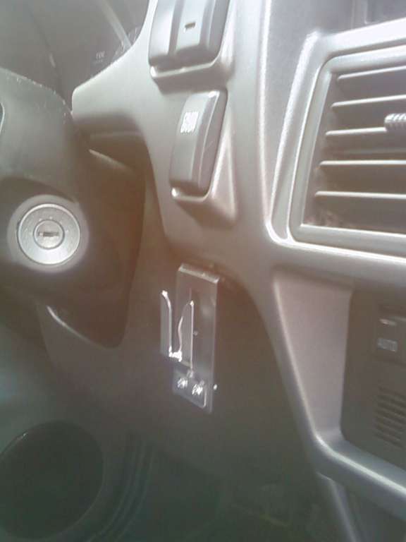

Close up of the mic mount. Just took a piece of flat stock aluminum, bent it to the shape I needed, painted it black, backed it with some rubber padding, and used the trim screw that holds the lower dash trim to the upper right to the right of the steering wheel.
