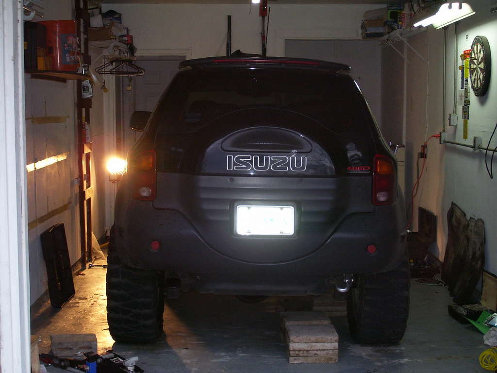

I had about 7 to 7-1/2 inches of space between tire and wheel well with just the OME 912 springs:

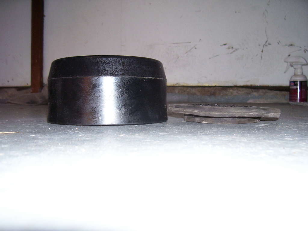

Here is a side to side of the Independent 4x 2" spacer on the left and the stock srping retainer on the right that it replaces:

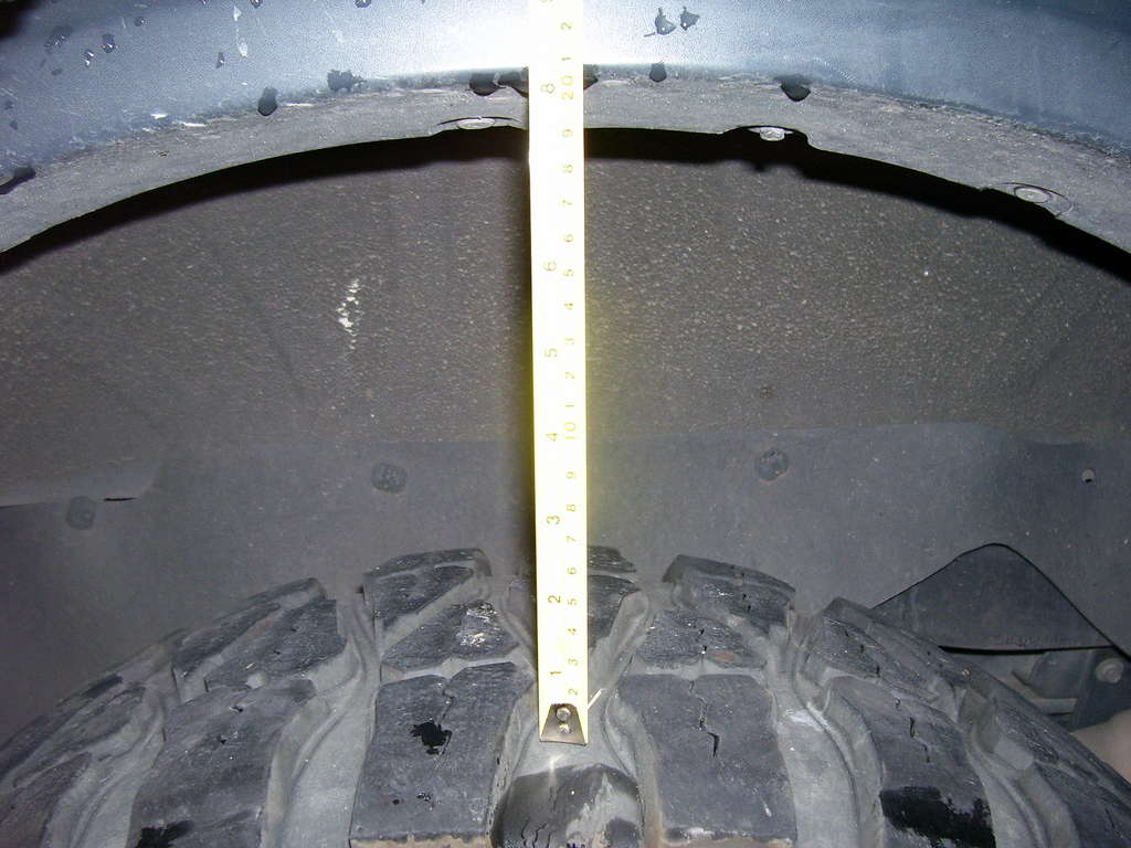

I now have about 8-1/2 inches of space between tire and wheel well with the OME 912 springs and 2" spacers:

Results:
Space between wheel well and tire now:
FL: 7-1/4" FR: 7"
RL: 8-1/2" RR: 8-1/2"
I think I might level it out just a little and now I am almost ready for some 35" tires

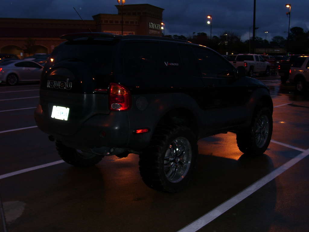

Before and after pictures, although I don't think this is a fair comparison because the before pics are all clean and shiny and the after pics are dirty and rainy, but I think you will get the feel for it. I always felt like the rear was a little squaty and now it is aggresive:
