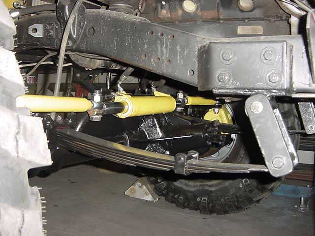

Moving on to the steering, which I am about to tackle next. I am attempting full hydraulic steering and a behind the axle mounting scheme with reversed high steer arms. Hydraulic steering is powerful, but has a bit of an Achilles heel. It is usually positioned out in front of the axle right where it can get bashed by rocks. So people mount it up high to hopefully avoid that. This is where high steer arms come into play. They bolt onto the top of a steering knuckle instead of about 2/3 the way down where your tie rod usually goes. I took it a step further and turned the high steer arms backwards (so they face rear) I am planning on mounting my ram above the pinion area of the axle to provide it some additional protection. The pinion area acts as a shield/sled as far as rocks are concerned. I am kind of going for what this guy has, minus the leaf springs:
I am a bit saddened because the ram I wanted to use is no longer being produced. Sean Stapley at Performance Offroad Systems is no longer in business and by all regards, his were the best. The current options available are:

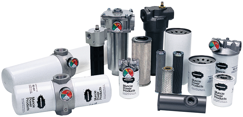

The filter is a bit of a nebulous point in the system. Many off-road systems use a simple screw on automotive style filter. It looks like an oil filter because essentially, that’s what it is. They are relatively cheap, reliable, and can be scaled up just by changing the size of the filter. There are also industrial type systems that use an external screw on filter body and an internal filter cartridge. They are usually sturdier and higher flow, but the filters are not as available/accessible and can be a bit confusing to deal with. I am currently looking into options for the cartridge based industrial versions, but I may end up with a simple spin on.

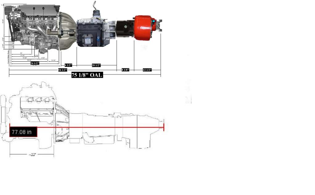

Powertrain wise, I just picked up the guts for the doubler. In the past, I was debating even adding a doubler because Justin (ZEUS) had me scared that the powertrain would be too long and I’d never be able to fit driveshafts. Well, let me tell you. I did the research and math and made these really ****ty refrigerator drawings to prove to him (and you) that I can fit a V8 engine, heavy duty 1 ton truck transmission, doubler, AND transfer case where the original VX stuff lived, plus have an inch and a half to spare! The doubler is going to be a Northwest Fab Eco box with guts from an NP 241 transfer case. It will bring the VX’s low range gearing down to around 100:1. Pretty darn slow. Here's the refrigerator drawing for reference:

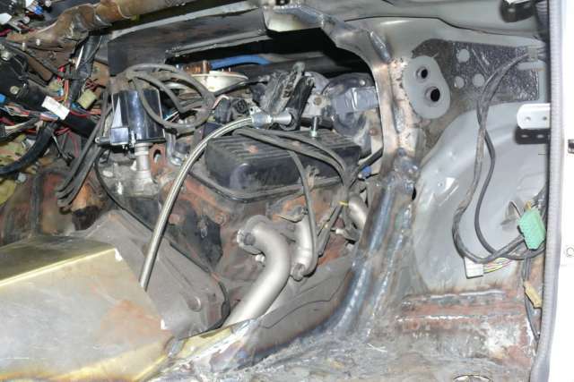

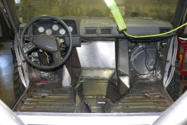

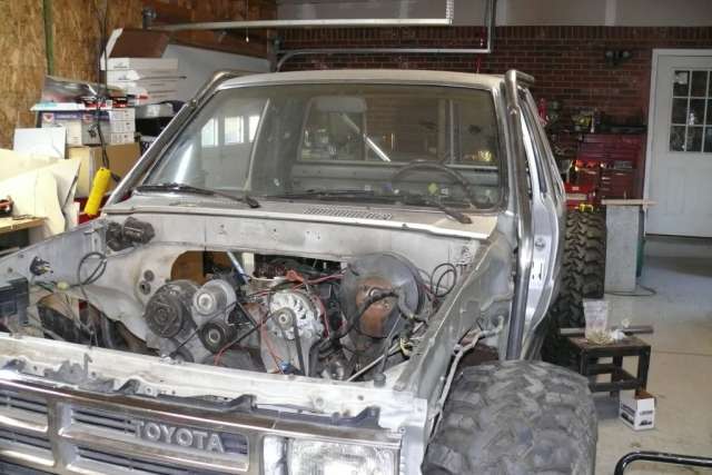

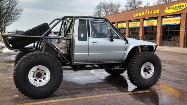

Here's the Toyota. Notice how the lines of an "Amigo bobbed" VX are similar to his rollcage/body....hmmm. It uses a smaller engine and has more clearance than the other truck. I am hoping for something closer to this as far as cab intrusion goes:

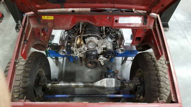

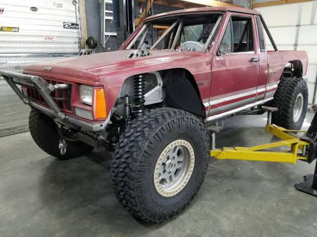

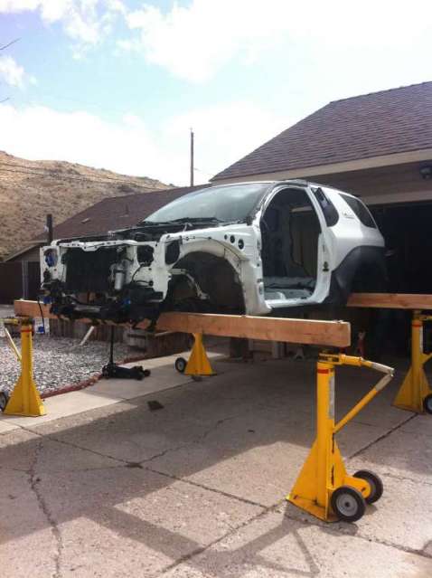

Here's the Comanche, a bit more recent build with a similar engine to what I am using. Notice how much less room the driver has for his legs:

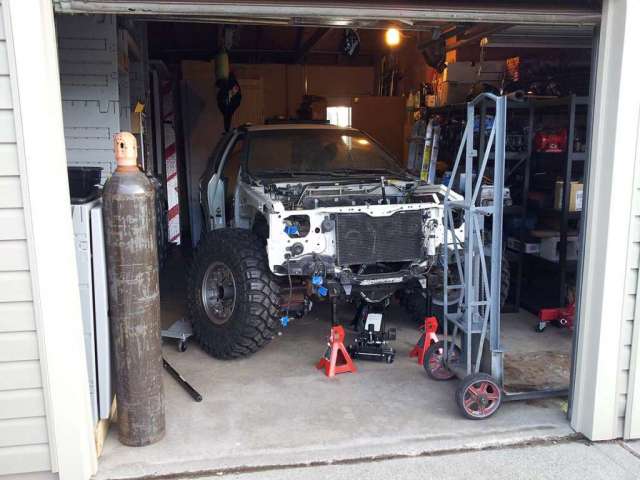

Here it is coming off the trailer after getting moved from the old apartment to the new house:
Hover mode from inside the garage:

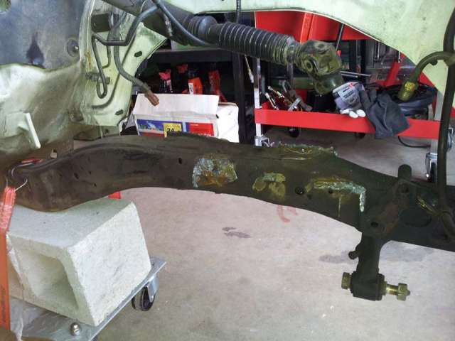

Getting some of the mounting brackets removed from the frame rails. These were a godawful nightmare. If you ever had a doubt about the VX, I can tell you firsthand it is better built than most tanks. Some of these brackets were attached and welded around the frame on all four sides. I have never seen or heard of anything like that. This was an early pic. The frame rails are completely cleaned up now.

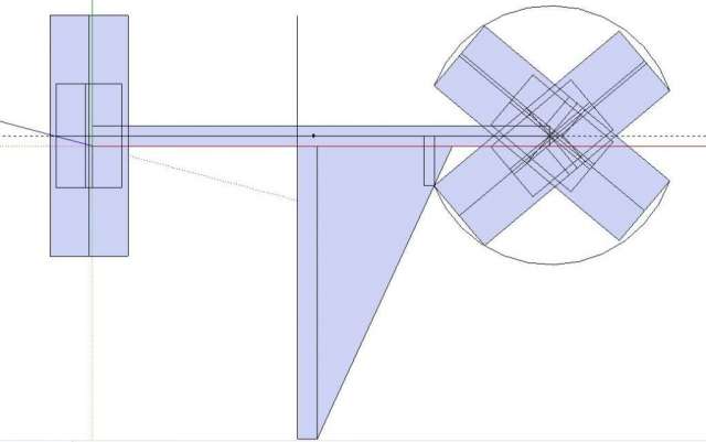

Here's a simple mockup using to scale axle width, proper rim backspacing, tire size and steering angles for 50 degree steering. I was seeing what I could get away with in terms of suspension linkages.

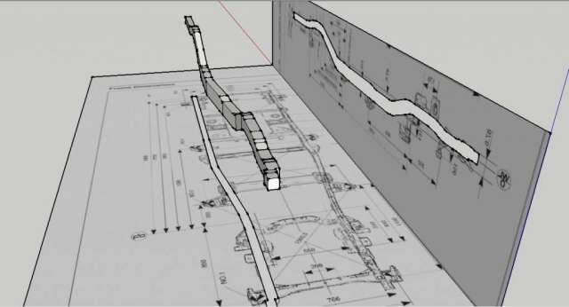

Progress so far on the 3D model of the VX frame. Struggling because this is my first time doing this, but so far so good.
