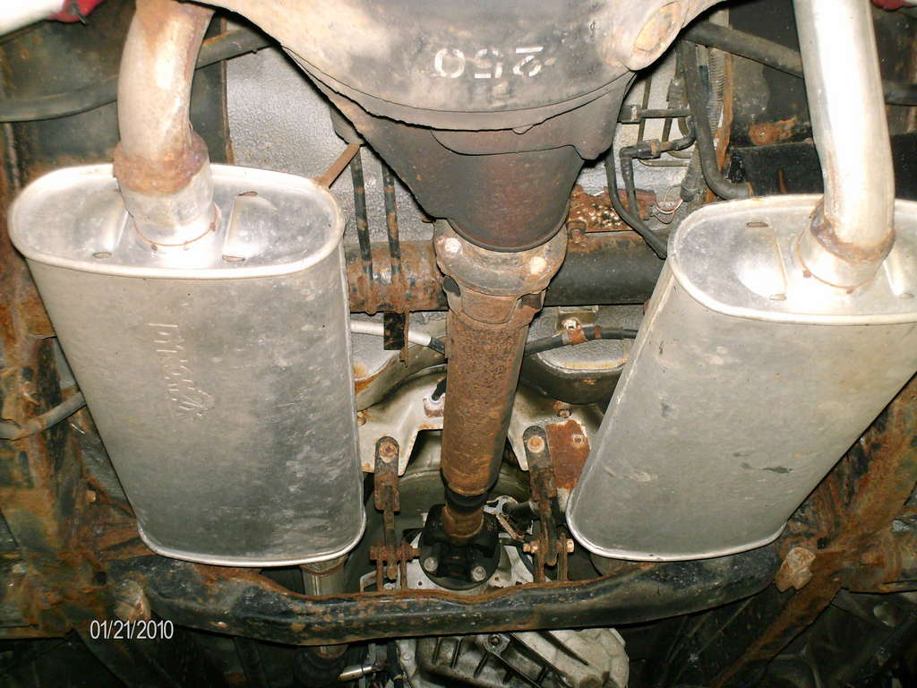

    Got any photos of that exhaust set up?
    I want to change mine, but you're the first that's said they have two mufflers. Sound sweet!
    Here you go buddy .......

    Thanks.
    This helps so much.

    Thanks.
    This helps so much.
    You are welcome.
    I went yesterday to my mech to talk about the rust showing under the carriage & while the horse was up in the air i took this shot.I tried to get more but the damn batteries died on me.
