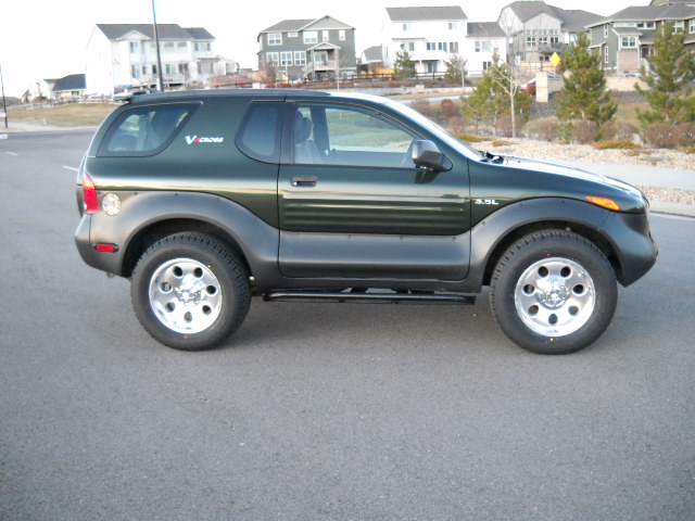

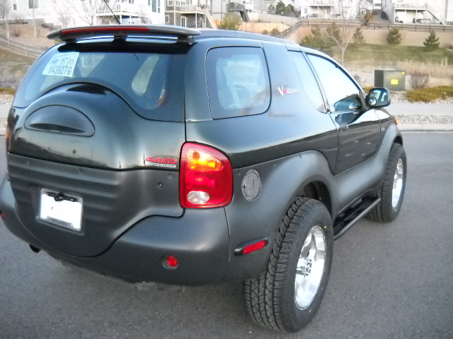

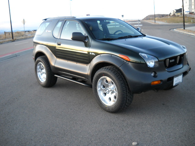

    Well I took the plunge (sorry Riff Raff, just couldn't let 'em go but you tried)
    MB Razors / 18x8.5 / offset -6 Yokohama Geolander A/T-S in 275/60/18
