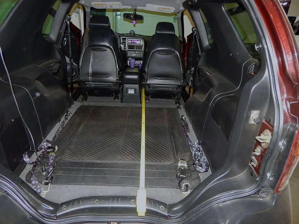

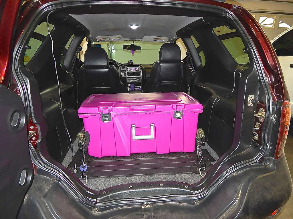

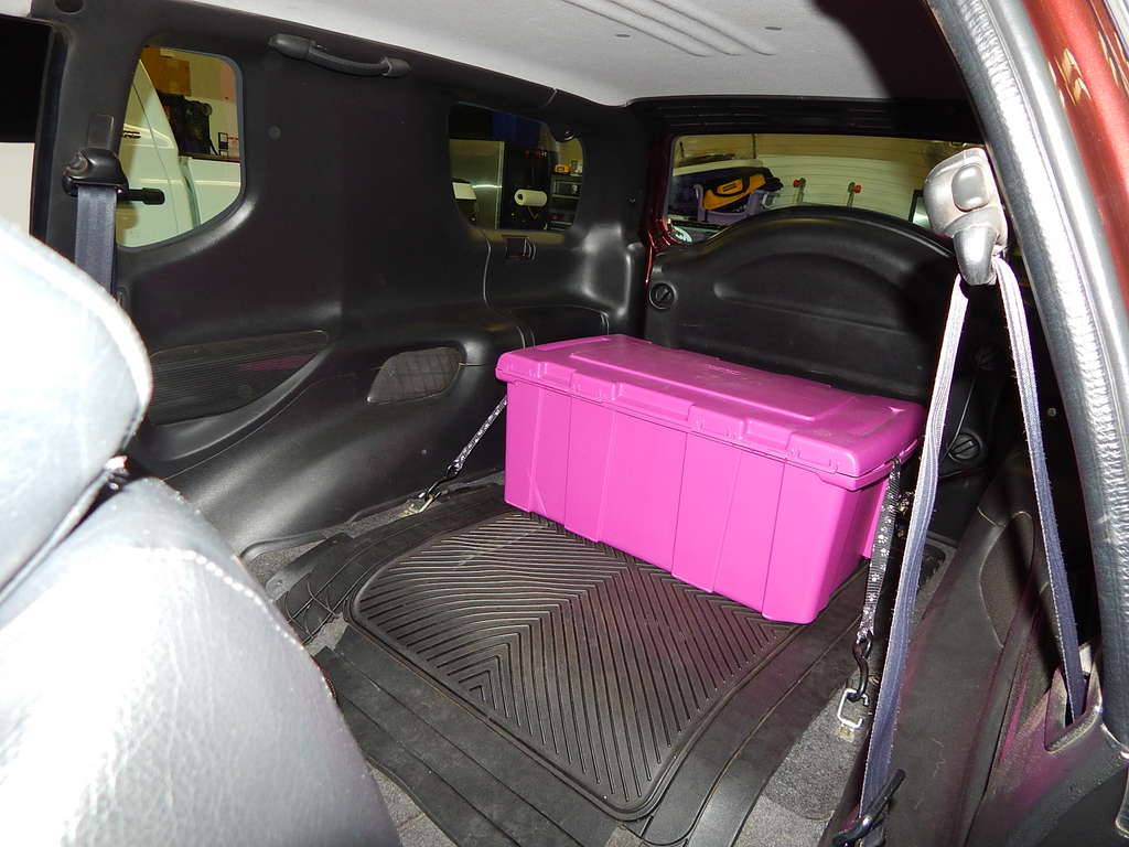

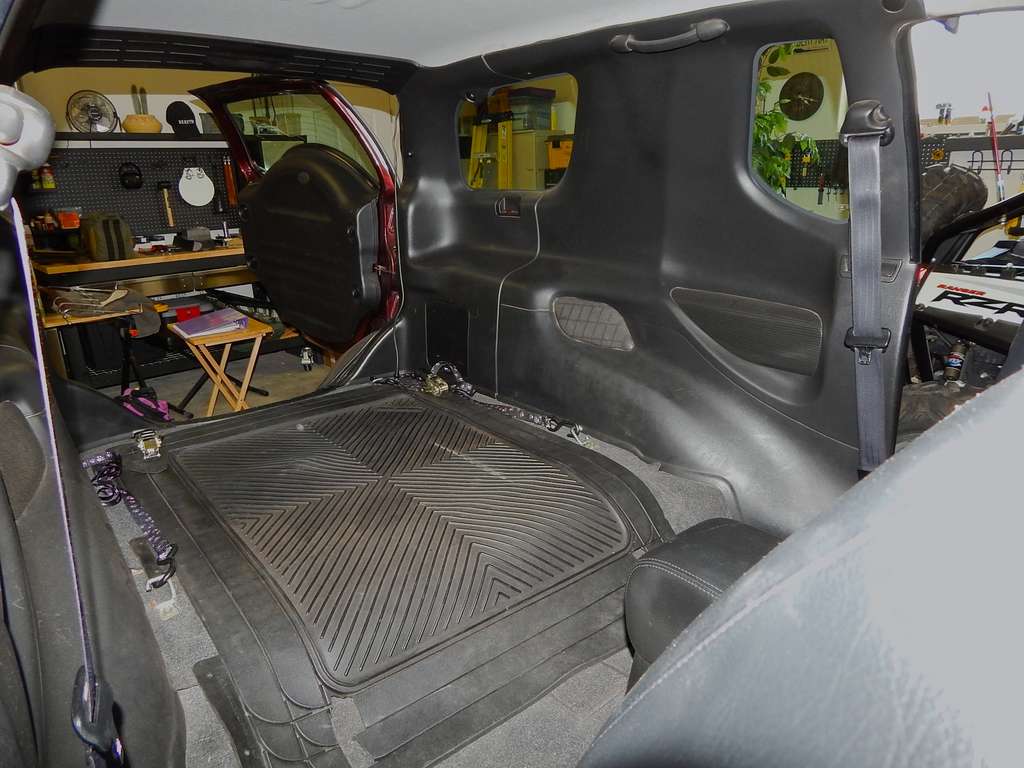

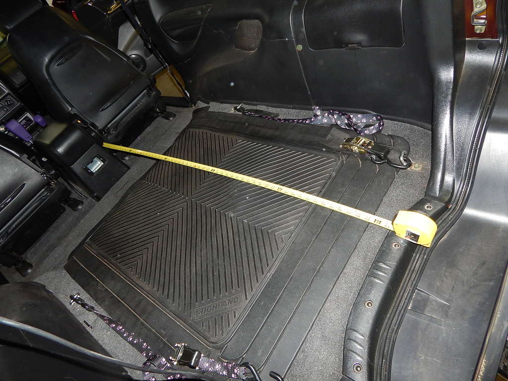

    After gaining inspiration from this thread I decided to take out the rear seat last night. And so it started. From Riff's post I selected option A because I didn't want those brackets sticking up when the seat was removed. After much profanity and scraped knuckles I soaked those two forward bolts in Bolt Buster and retired for the evening. Back at this morning. Called a friend. got hold of an impact hammer. What a PITA. It's out now and in the basement. Definitely not for the feint of heart. Put's a whole new ceiling on frustration tolerance. Highly recommended.
