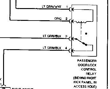

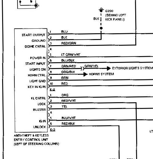

    Here's a diagram:
    The wire to look for is a blue one the diagram calls start output (it goes to the Automatic Transmission Mode Switch). It is only grounded when in Park or Neutral, making it a perfect safety switch.
    Another mod you can do is wire the remote to open both doors when you press it once, then the back door when pressed twice. Both this mod and the wiring schematic was sent to me by a guy down in Florida who wired his VX in this manner (Gary Bucklew of Autodoc in Largo, FL).
    The Passenger door lock control relay is the one to access to wire the popper to trigger off the second press of the factory remote. Just splice the two light green/black trace wires together (cut the one that is the true trigger) so that both door locks unlock on the first press of the remote (thus bypassing the relay), then get the wire that originally went to the passenger door lock actuator (the one you cut), and use it to trigger your relay for the popper. The factory used the passenger door relay as an inhibitor relay to NOT open the door on the first press.
    Note that I have not done the second mod, so I'm not able to give better, more detailed information. I'm planning on going to an aftermarket alarm, so making this change is moot.

    REMOTE hatch release!!!
    Using the wiring diagram posted by Johnnyapollo, I now have a REMOTE hatch release. Beware though - according to his diagram (and the one in the shop manual), the relay is behind the right kick panel - maybe my VX is bassackwards, but it was behind the left (driver's side) kick panel on my car. About a ten minute job, if you don't tear the wrong side of the car apart looking for the relay.
    Now one press of the remote button unlocks both doors at the same time (how it should be IMO), and a second press pops the rear door - Fantastic!
    The relay is in an access hole behind the LEFT kick panel. It's round like a turn signal relay, and is wrapped in a grey foam material. I just cut one of the lt grn/blk wires (got lucky, the first one I cut went to the passenger door), which on mine was the longer wire. I then ran a wire to the output side of my trunk popper (output side being the side with the wire that goes to the rear popper), spliced the two together, and wah la! Oh, and don't forget to splice the other two lt grn/blk wires together so both your door locks will work.
    Jul 2003
    2001,Ebony,VehiCROSS,1092
    753
    Ooops! spoke too soon - I DO have an opener that works with the remote - which is cool, but now I have created problems.......when I unlock the doors using the power unlock button on the doors, it pops the hatch as well. If I use the remote hatch release button in the glove box, it works once and then blows the in-line fuse in the popper kit. I went back and checked all my connections - anybody have an idea how to make it work properly???
