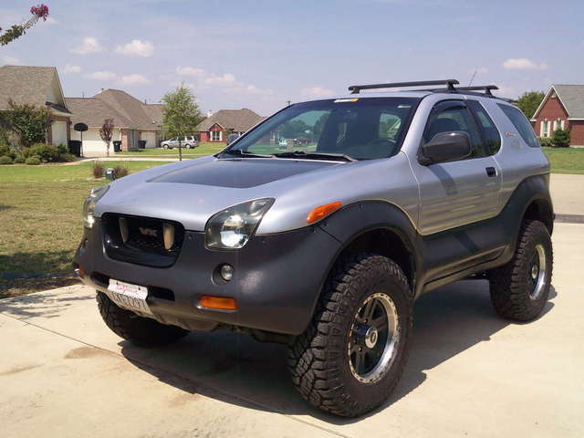

In the middle of this, I took her out mudding/crawling. This was earlier a few weeks, when it would only stall on re-starts. I got around it by using gas pedal on warmed up starts. That, or opening the fuel cap and releasing pressure. WOrked pretty much all the time. But the mudding made me want a lift. First time I went out with this group of guys, and as many of you know--they were all surprised to be impressed by the funny EYE-su-zoo. But ground clearance kept me back on two hills. So I raised the stock VX 3inches with new 32 tires.

Idle probs gone. After all of that, I had a lifted VX with larger tires. I was expecting the gas mileage hit. The speedo was wrong, it took a while for me to get used to the body roll with the new springs. I was just happy that there was no stalling goin on anymore. I got 32 in tires installed and when getting an alignment after the lift/tire install, the shop noticed a wheel bearing leaking. THey fixed it.

After getting 15MPG for for the entire time I've owned my stock VX, I AM NOW GETTING 19.5 MILES PER GALLON AFTER A 3INCH LIFT AND 32INCH TIRES!!!!! I am happy, happy, happy. It took a while to get used to taking corners slower now...i come from a love of sportscars and the stock VX...and the OME 912s felt, well, sloppy, initially. I figured it was all tradeoff. I was expecting inaccurate guages, sloppy handling, and worse mileage for the sake of climibg over a couple rocks or getting past deepr mud pits. Initially, I kinda had regret on the tradeoff. But with the MPG, forget it. I love this truck.
