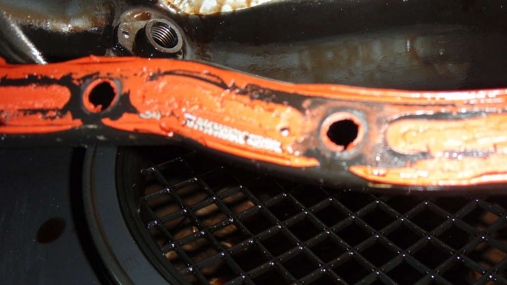

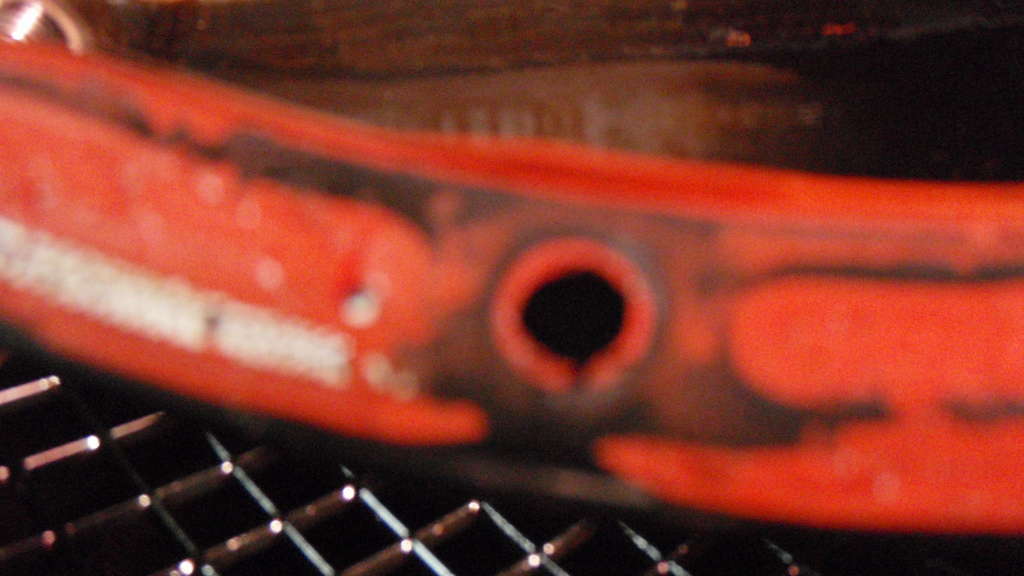

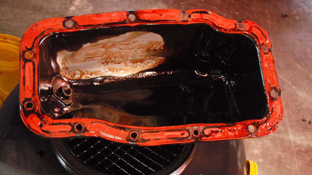

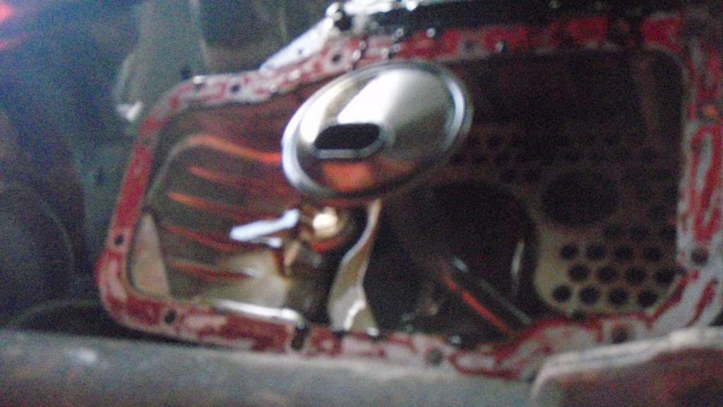

This is the condition of the old gasket upon removing the pan.
The old gasket appeared to be made of silicone as it was stretchy like a rubber band and very hard to remove from the pan. (best way i found was using a green scratch pad to remove stuck on gasket.)

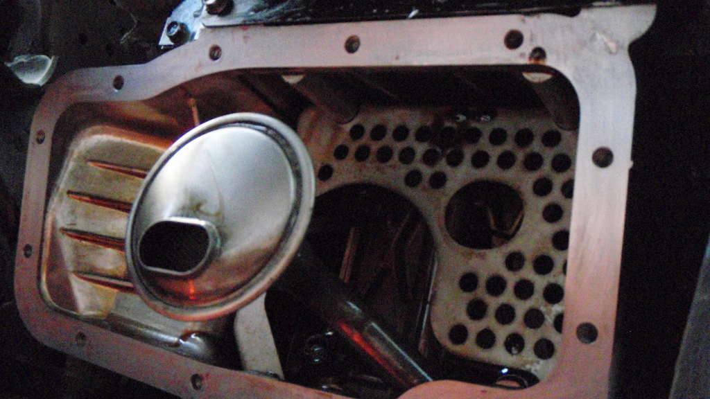

all clean

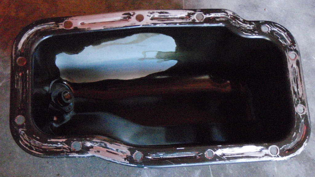

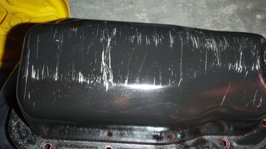

This is the bottom of the upper oil pan you can see lots of gasket fragments.
All clean( used a razor blade to scrape)

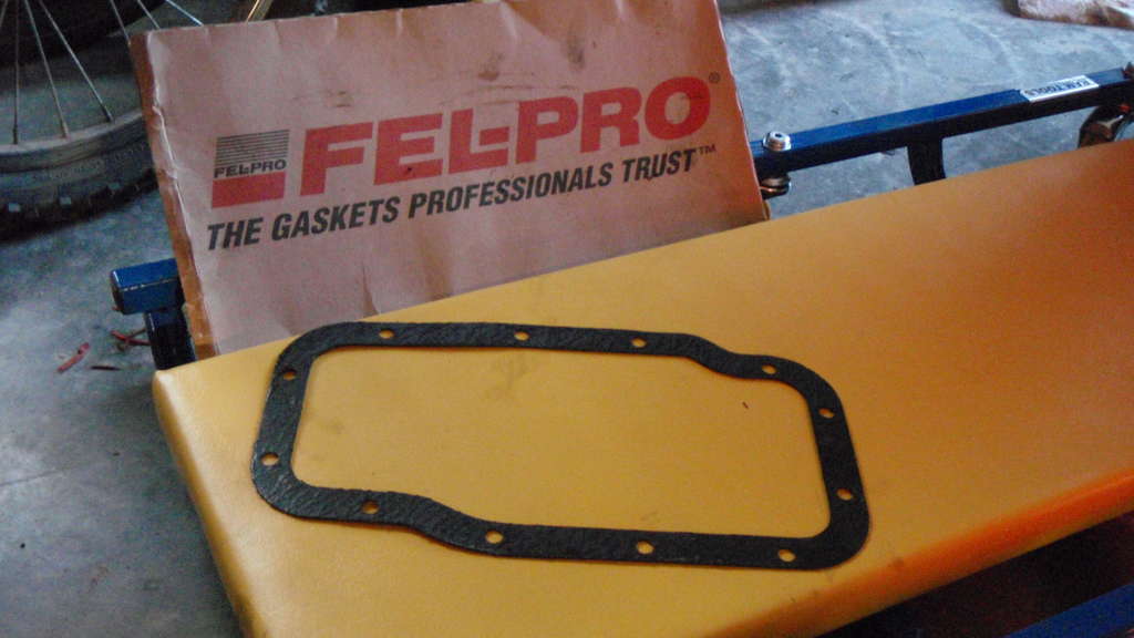

the gasket

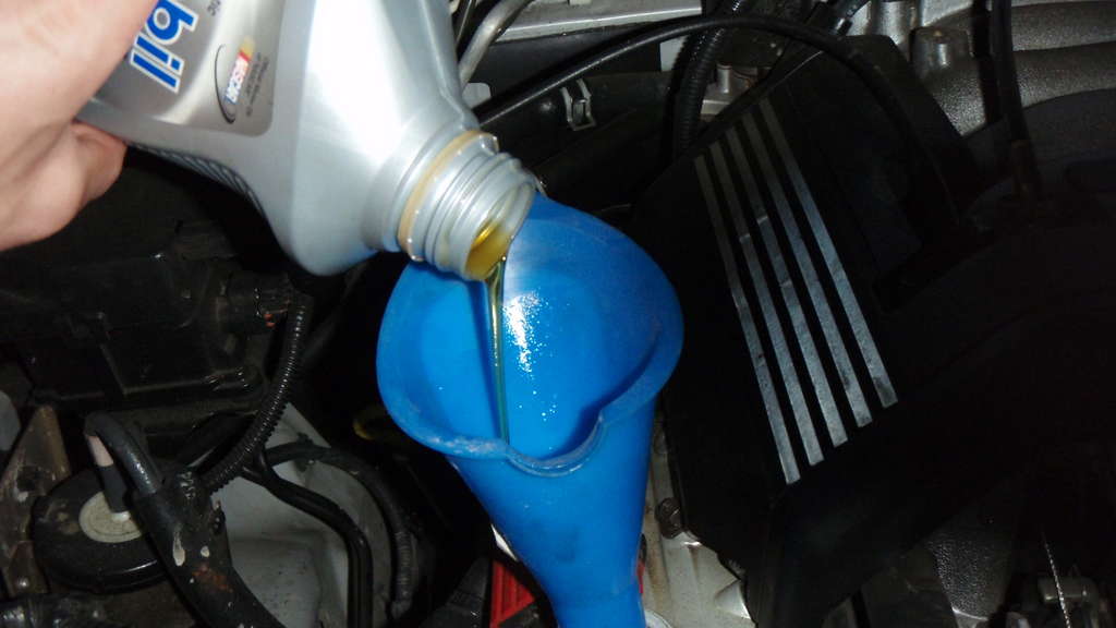

When droping the oil pan you can get a full oil change( over 5 qts.) so make shure you have enough oil to fill her back up!
A good time to use synthetic and a new filter.
That oil is expensive! try to get every last drop.
