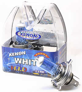

    found these on ebay
    [IMG][/IMG]
    (there are all kinds on ebay 4000k - 8000k) all claim no modification required.
    this one says:
    They draw the same wattage as your OEM stock bulbs Standard Wattage Draw: 55W/60W
    my question is would I still need to change the fuse or is there a specific W I should not exceed?

    Quote Originally Posted by VXR View Post
    found these on ebay
    [IMG][/IMG]
    this one says:
    All depends on the price,if they are cheap don't bit it.If the wattage is 65/55 no other fuse upgrade is required
    High performance bulbs doesn't cost cheap as the regular 65/55watts.
