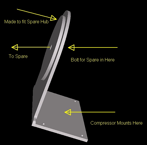

Yes..............I could make this!
I dont stock that size of steel which means i gotta buy a whole length to make one mount, then im left with what ever isnt used $$$$$$$
Are you talking about thickness or other?
Scott, you can also lighten up the mount by drilling several 1inch holes in the plates....it will also assist with cooling of the compressor. I am keeping an eye on this thread and may mimic it as I have the same compressor.
????? Will the hose reach the front tires with it mounted there or have you replaced the hose with a longer one?
The hose I have that came with the pump reaches, But I'll probably fins a different one. I need some bulkhead mounted speed connector and a real chuck rather than the Mickey Mouse screw on one that came with.
I'm shooting for the ability of using the compressor without having to remove the spare tire or the cover thus, it will be wired, switched, protected and have a hose system that would blend in seamlessly.
