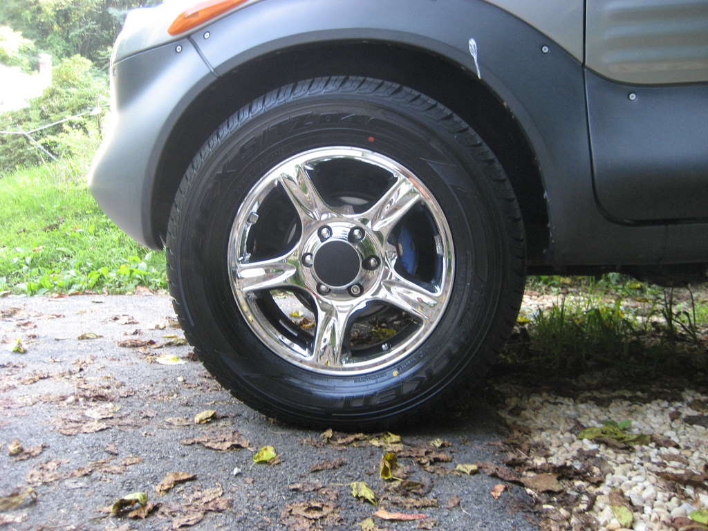

    well i heard too many bad reviews about the goodyear fortera tripletred wearing badly, from a few different people ive been hearing they get really hard as they wear and loose traction quickly.. so i actually got a good deal on a set of 285/60/18 Falken ST/Z04s its a really nice looking tire, pretty good reviews from the UHP market.. and ill be paying about $100 less per tire.. they arrived today.. will be mounting sunday

    I like-em too, and boy the color of the VX is totally awesome. SHARP RIG !
    They look terrific! Love the tread pattern.

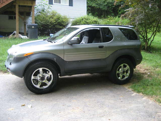

    couple more photos

    Forgive my ignorance, but what's to stop a much taller tire from bouncing up and hitting the inside/outside of the fender/cladding if you don't also do a lift? I figure that's what the bump stops are for, but are the OEM stops designed to stop this large of a tire?
    I'm sure a lesson is coming so I've got my pen and paper ready.
    Wrench
    The lift wiki. . http://www.vehicross.info/modules.ph...warticle&id=66 . .has part #'s for a higher profile rear bump.
    The front is usually clearanced by trimming, & if the offset/tires are too large, the good old fasioned . . mod comes into play...
    Last edited by Moncha : 08/18/2009 at 11:40 AM Reason: Put new link in to How To Section
    The PO put a spacer under the bump stops on the front of mine.
