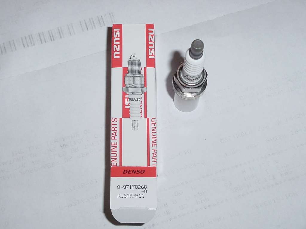

    Not to spark ( MAN, I am so effin' funny) another debate here, but I had to order my timing belt/ water pump replacement parts from Merlin the other day, so while I was at it I asked him about the spark plugs since they need to be changed too. He said that Denso's came in the VX originally so I had him send me what they use to replace the plugs in their shop. I figure since the original Denso's have lasted me almost 100k miles that they're good enough to go back in the old girl.
    Isuzu replacement Denso plugs. Denso K16PR-P11
