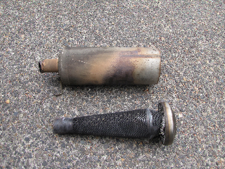

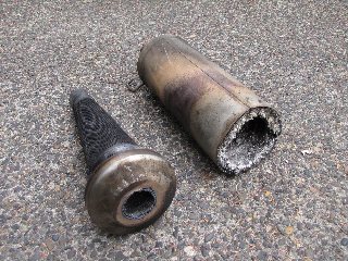

    I decided my Power Vault I was getting too loud after 75000 mi. As a historical note, when I got it off, I cut opened the body to have a look at the construction. Seems to be just a heavy duty glass pack.
    I found an inner straight through perforated tube shaped like an expansion chamber. The fiberglass was missing in one large area. The stainless steel was still in good shape. I could repack the fiberglas and weld it back together almost good as new.
    At the recommendation of my muffler man, I tried a Magnaflow 4x9, 20" body, which is a straight through design in stainless steel, it is a little more quiet below 2000 rpm, but hits a loud resonance at 3200 rpm. Not good.
    I did replace the tail pipe with a stainless 2 1/2" all the way to the stock tip, also 2 1/2".
    Next I will try the Dynomax Super Turbo 4x9. Not in stainless, but still lifetime warrantee. The three pass design will have a bit more back pressure but I don't expect it to be noticeable.
    Two photos in gallery.
