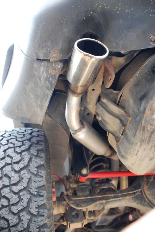

I think things went bad when the right side coming too close to the tire, about 1 in. I made a stink about this. He then had to re-bend, hack and whack to get pipe away from the tire.
He started on this job at 1:30 PM and finally finished at 11:15 PM (9 hours, 45 minutes) later.
He had lots of interruptions.
Very bad splice on the right side. The pipes were not fitted properly and welded crooked.
The shop put pipe clamps over the welds on the two connections exiting the muffler, I believe this was a way to cover some of his mess.
Bad bending especially at the connection from the muffler to the right tail pipe. The pipe goes into muffler at a 20? angle
The Tips are not straight
All the arc welds are lumpy and rusting
The hanger on right side was made from tacking a bolt to the frame
The pipe size used is 2.25 in. The shop flared the pipe to fit the muffler
Magnaflow (14218) Polished Stainless Steel muffler 2.5 in. single in, 2.5 in. dual out
I wonder if muffler should have been 2.25 in. not 2.5 in.
