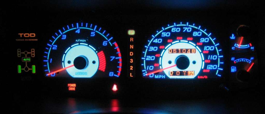

As for the miles to kilometer on the speedo - useless.
There is no gauge cluster you can put in to replace the Vehicross cluster. The typical solution for the dealer is to put stickers on the speedo to indicate that the ODO is in "miles" and put little numbers next to the miles as kmh equivalent. (i.e. "100 km/h" sticker next to the 60 mph tag.) My dealer thought it was dumb, so he just ticked off on the form that he did do it, but didn't. In the end I put in glow gauges that had Km/h and mph. (FYI - these are hard to find now)
I did it more for the look as opposed to getting km/h.
