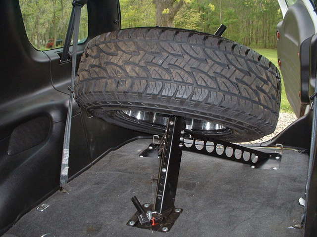

    Thats my plan. Plans are in my head and a guy at work said he would give me some of the metal he has and weld it if Beau isnt available for it. I need the room back there for the pup and what not, so I couldnt mount it like Jolly rogers.

    Alright, first update, no way its fittin inside without major mod to interior door frame, so that is a no go for me.
