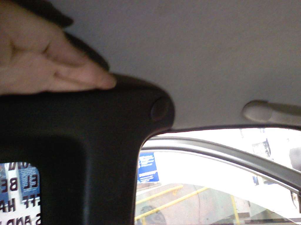

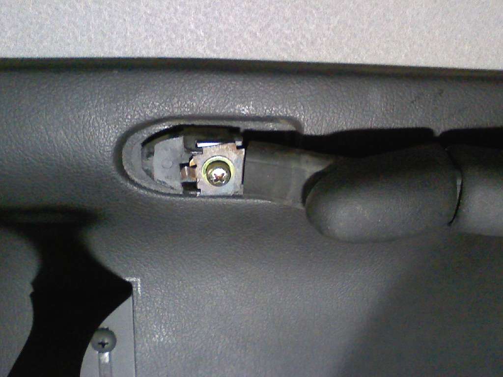

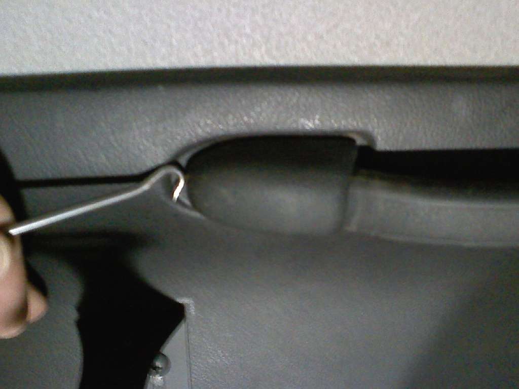

use a pick tool to pull the ends of the caps that go over the grab handles...
so, this is what it will look like after you pull the caps off

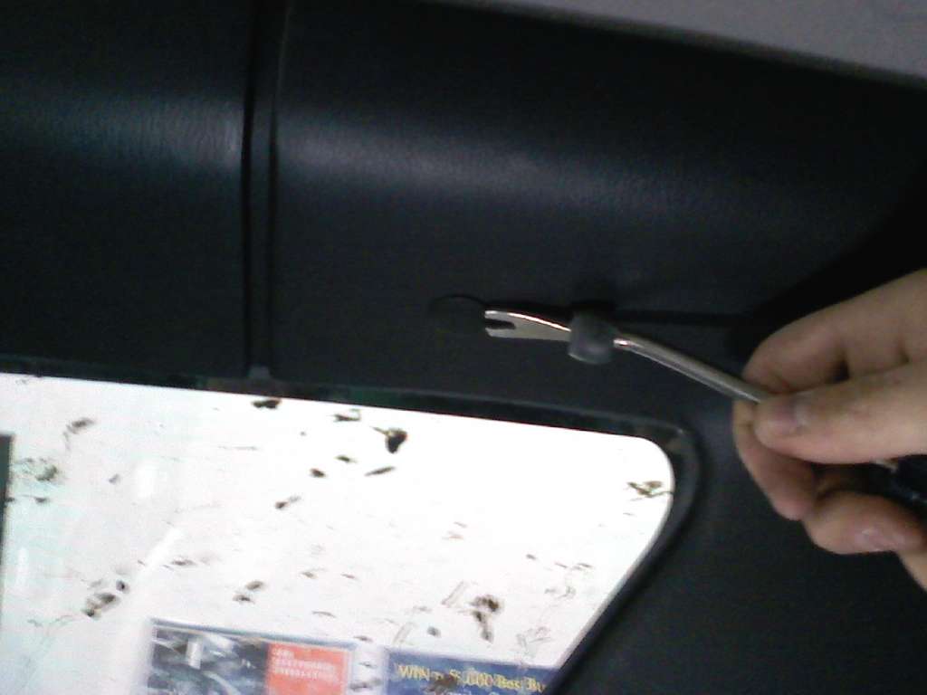

next pull all the 'christmas tree's' off...

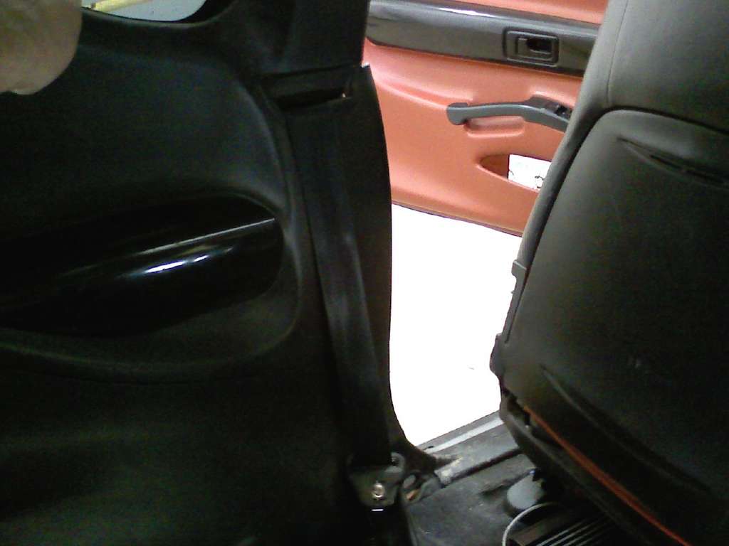

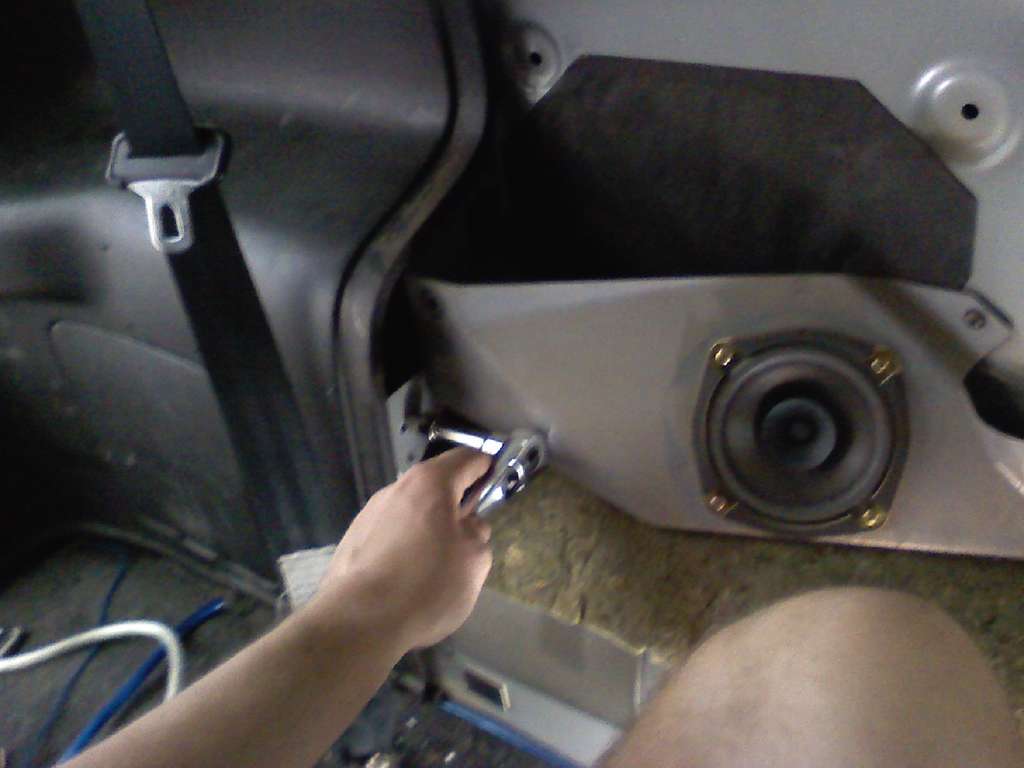

next you need to remove the seat belts...i did the rear first...

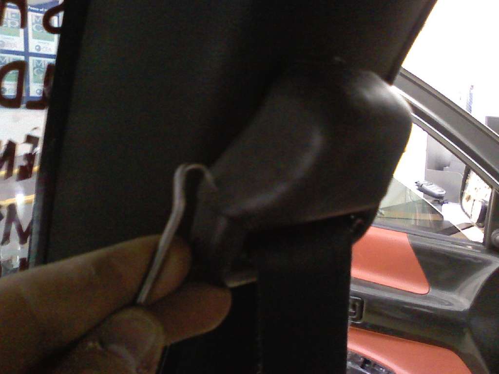

i used the hook pick tool to pop the covers off the front seat belts

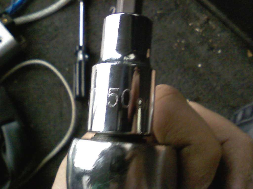

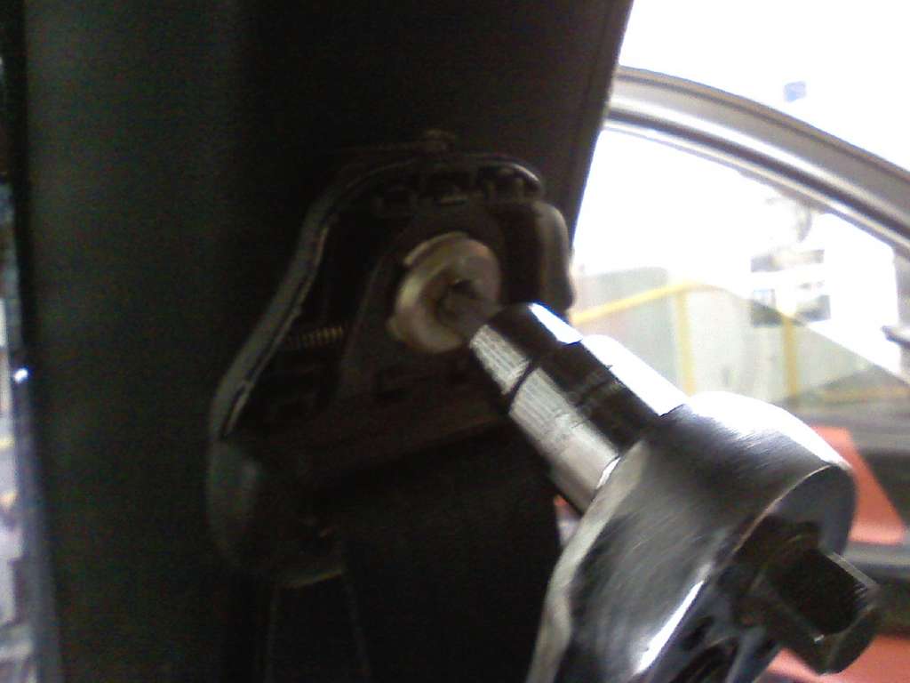

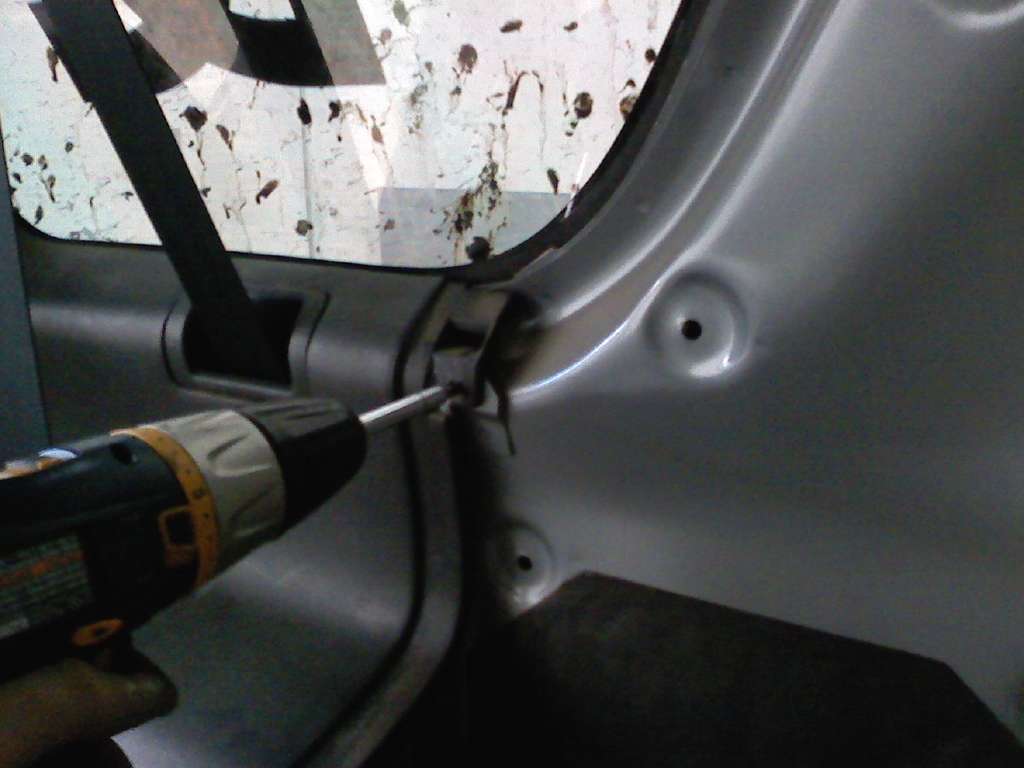

next you will need a T50 Torx bit to remove the top of the seat belts

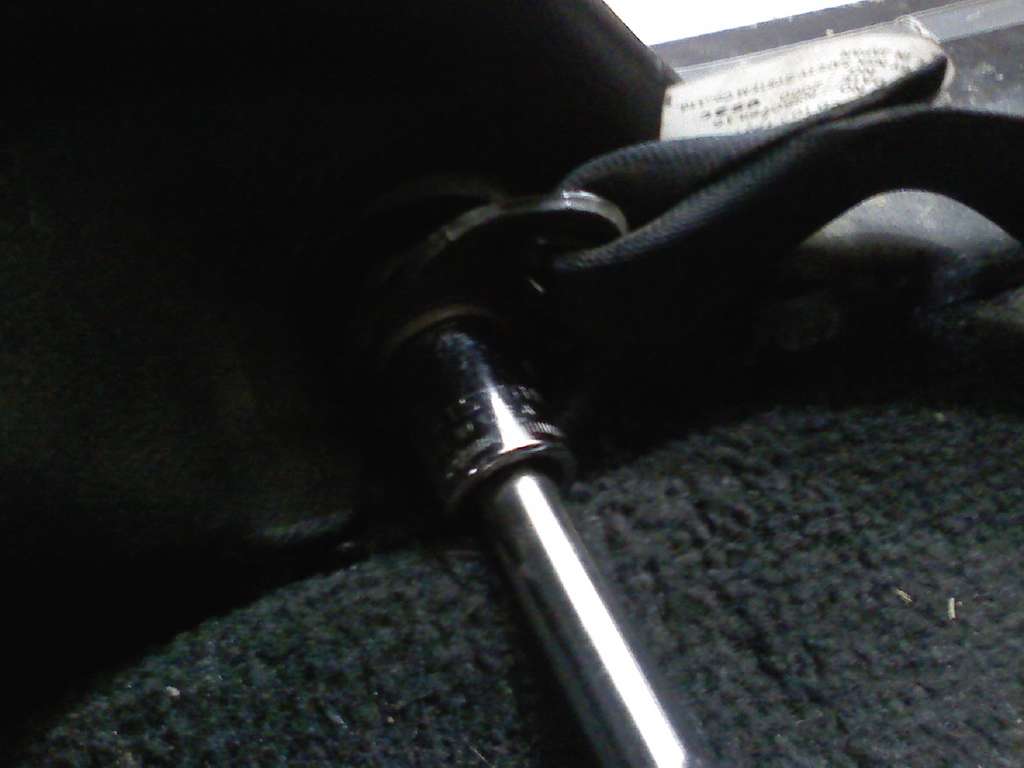

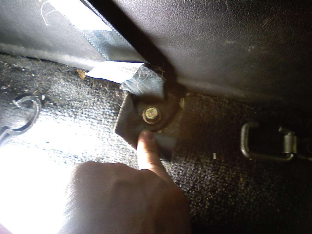

remove the bottom of the front seat belts

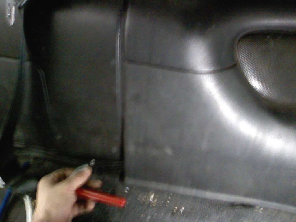

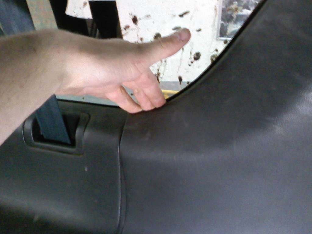

there are about 15 pressure clips that hold the rear part of the panel on... i started by pulling on the area near the rear at the top...
the bottom is pressure clipped and velcro'ed
next i pulled the panel to pop the strange clip near the doors...
then push the whole panel towards the 'front' of the vehicle to get it to let go of the edge of the door

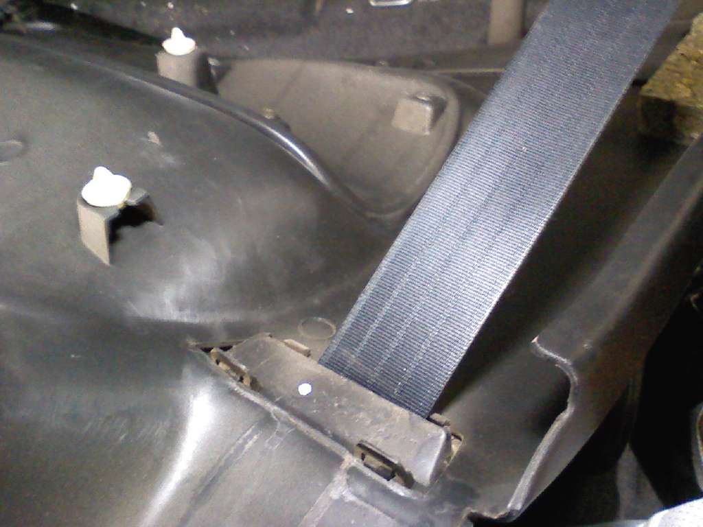

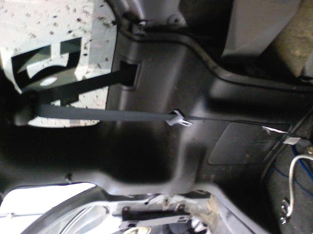

then, if you look behind the panel, the piece around the seat belt unclips.
this leaves you with only the rear part...

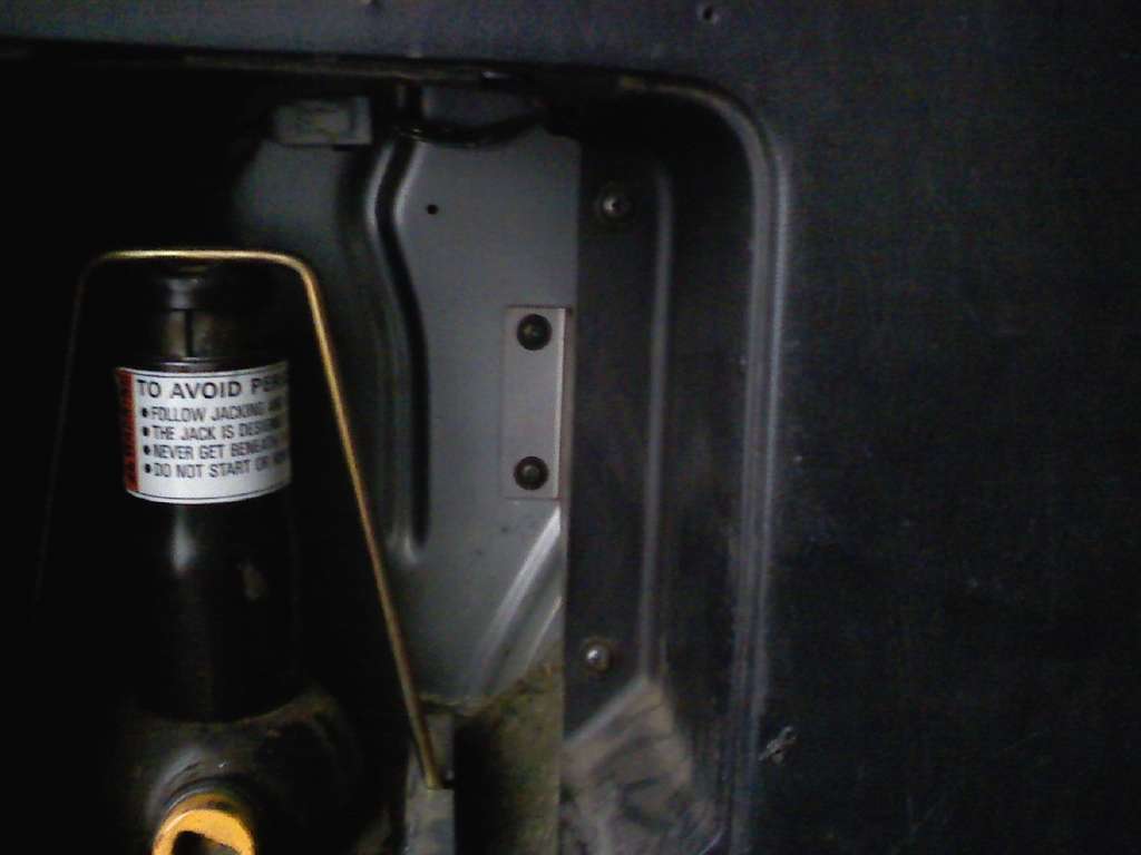

screw here...
screw here...

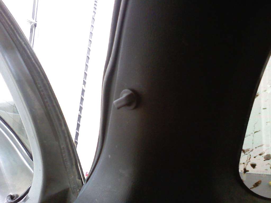

unscrew this with your hand
take these two screws out

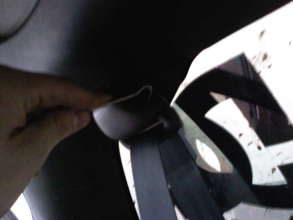

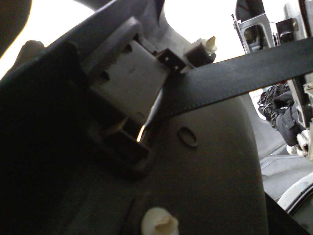

unclip this cover over the top of the seat belt
then same as the front, look behind and unclip the cover around the seat belt
