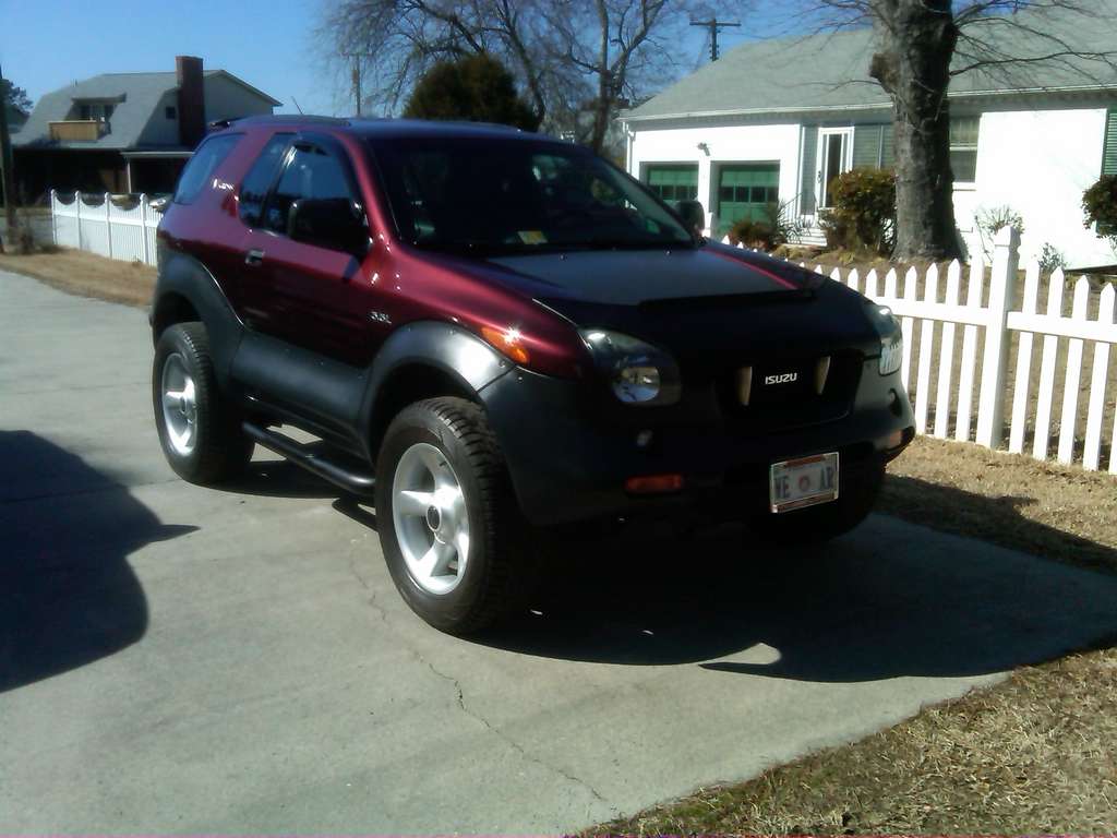

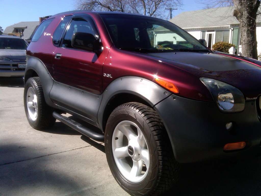

    Review of Daystar Spacers
    Piling onto rickshaw's review to avoid starting another thread...
    This past weekend yellowgizmo99 and I installed the Daystar Spring Spacers on my VX. Last year I went to 265/60/18 tires on Borbet CW3 rims with a -2 offset, which pushed the tires just outside the wheel wells. An aggressive look for sure, but the reduced distance from tire to cladding worried me. Aside from looking more like a sports car than a bad-*** SUV, I was concerned that offroad articulation might cause the tires to rub the cladding. In addition, I added Tone's nerf bars a few years ago which caused me to lose about an inch of ground clearance.
    So with all that in mind, I decided to do a very mild lift. Lots of members have reported problems related to tearing CVs when going to 3" or more, so I wanted to avoid something that drastic (in my mind at least). After reading rickshaw's review I decided to try out the Daystar Coil Spacers, which were only about $35 shipped. It took Billy and I a couple hours to get them installed (thanks again Billy!), mostly because neither one of us had done it before. Aside from the coil spacers we cranked the torsion bars by about 5-6 complete turns to raise the front end while maintaining the OEM rake/angle. (Useful information I found while searching on Saturday: 3-4 turns = about an inch of lift, and both bars need to be cranked clockwise to go up, counter clockwise to go down.) Judge for yourself, before and after pics appear below (sorry for the quality, I took them with my crappy cell phone camera) followed by ordering info. I'm VERY pleased with the outcome, as this is a very subtle, cheap, and useful mod.
    Installed Picture:
    Before:
    After:
    Before:
    After:
    What to Buy:
    Where to Buy:
    http://www.google.com/search?q=Dayst...65f9b59bf7e6e1

    Do you feel like that made the ride more comfortable by raising farther away from the stock bump stops?
  13. #43
    Oh, good question JAMAS! Logic would seem to say yes, can't wait to hear.
    Mav- it looks great, not too much, just perfect! You know what, I think (IMHO) it may be time to replace the amber lenses (turn & triangle)...the whiter lens would go better with your wheels & rack and give better symmetry. I know the triangle lenses from Klearz haven't been the best fit, but you can sand them down to fit better. mhill just did it, and put some black striping around the edge closest to the paint.
  14. #44
    Hard to say on the ride comfort, trimming the bump stops made such a huge difference that I was rarely hitting the stops before the lift. What's interesting is that a lot of members have reported better ride quality after their 3" lifts, but by cutting the stops and doing a 1.5" lift I've effectively created the same spacing without the additional lift and associated suspension geometry change.
    I've debated going from amber to white so many times I couldn't even count. Maybe I can convince Billy to let me try out his clear triangle markers to judge the difference. For now I'm holding off because I'm planning on having my calipers spray painted orange at my first brake service (that's right ladies and gentlemen, 11 years on and I'm still on the original pads and rotors). Got to keep with the Virginia Tech theme.
