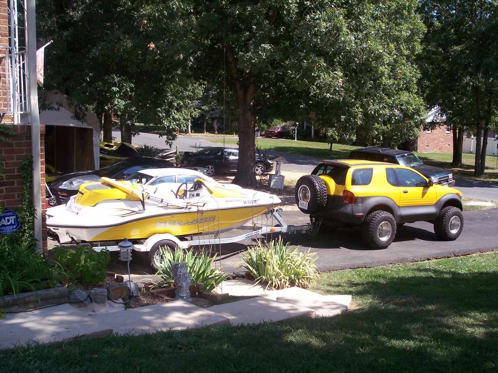

    you mean like this?
    I wouldn't go much more than 2000lbs since that's approaching the vehicle weight. You should be fine with your set up though.

    Or this...

    Or this...
    Yes, now that's different. I'd just be really worried about the "heat" possibly scorching/melting the plastic rear cladding. It would be the same as parking your VX really close to a open camp fire (not very wise). How 'bout you try it out first near your plastic rear cladding, then give us a product review (or an insurance incident report).

    'Scuse my typo, I meant to say 3000lbs. My SeaDoo is prolly about 2000lbs and tows fine. The twin pack of SeaDoos is even less & tows even better with the wider stance (it's almost as wide at the VX with the offset from Hell).
    I agree with Canadian, for short hauls to/from the lake, the VX is fine for towing. For long hauls, you should at least add a tranny cooler.

    Borrowed from Bantan's gallery:

    Sheesh! Does anyone know what happened to etlsport? He never reported back...
    Return evil for evil to no one...as far as it depends upon YOU, be peaceable with all men. Romans 12:17, 18
    He survived the trip. IIRC experienced no difficulties whatsoever. If you check his gallery, I think he has a pic of the setup.
