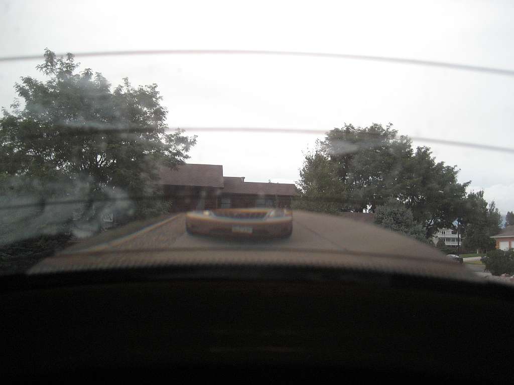

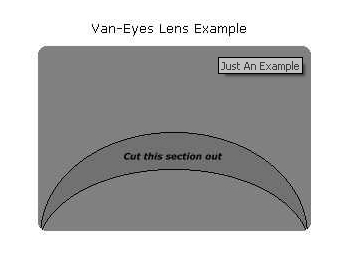

    I too use a Van Eyes and had cut it down. You really don't need a full lens. Here's a few pics to help you decide on what you may want to do. They are quite effective on keeping your butt out of trouble.
    #1)Green shows placement #2)Idea of what to cut #3) View through #4) Etc.

    I bought mines at strauss auto for $ 12.00 a piece & placed the whole lens
