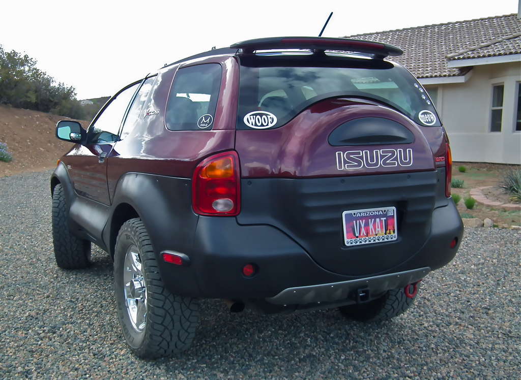

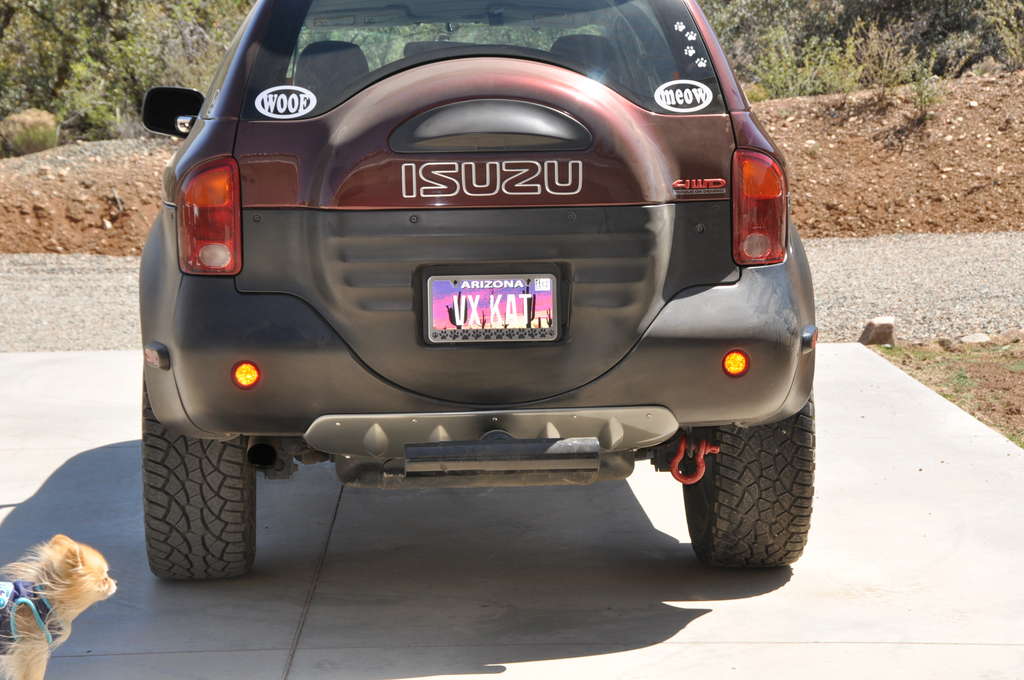

    ~ Also upgraded to the 24" black powdercoat sparebumper.com. Looks nice and beefy. Interestingly, we couldn't get the 24" superbumper in my receiver......tried dremeling it but that was way too lightweight...I needed a grinder! So we took it to the off road shop for some grinding! Both the inside of my receiver AND all 4 sides of the superbumper had to be ground down...goodbye powdercoat! Will have to spray both a little to prevent rust.
    Thinking of using the 18" as a sacrificial lamb off road.....thoughts on that? I could argue either way....it sticks out so it will catch more things, but it will also protect the rear skid/cladding.....
    18" sparebumper.com....and Teddy catching some breeze! Truck is covered with AZ desert dust....but my cladding is still nice and dark under all that dust!
    24" sparebumper.com

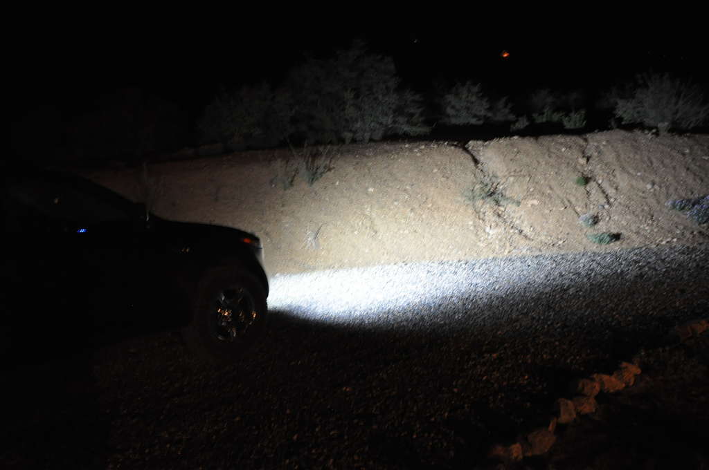

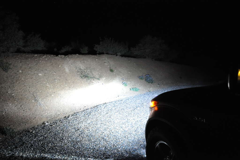

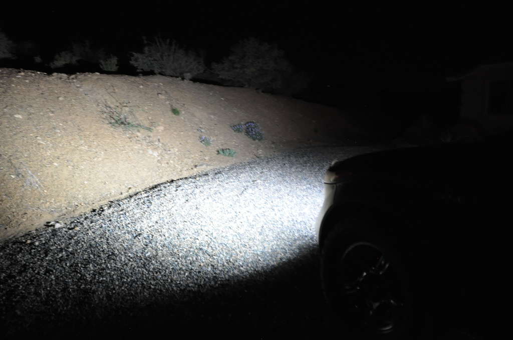

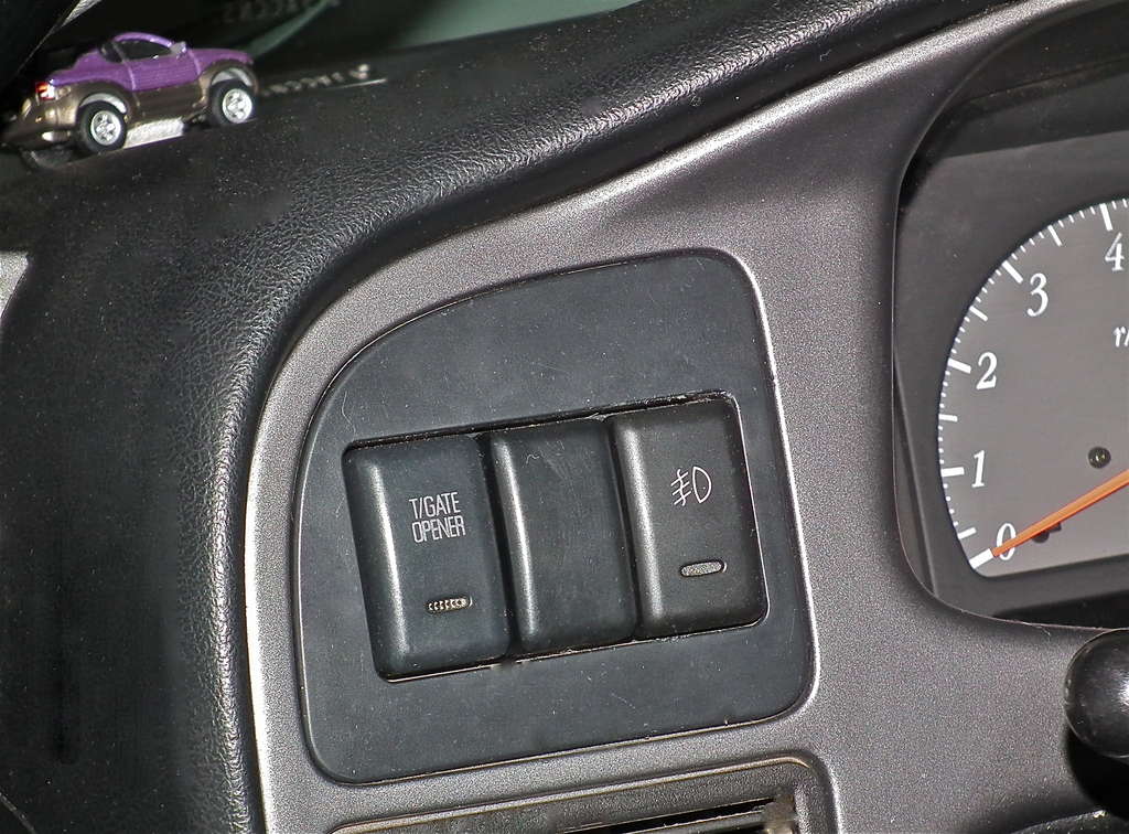

    They're 2" round, with 40 degree beam pattern. About the same size as the Hella Micro DEs, but are 10W LEDs, lifetime warranty, mega bright. My stereo shop built brackets for them and used the OEM lens cover (although cut down), real clean install. Had them wired to my new OEM Rodeo fog switch on the 3 button panel. These pics don't even do them justice!

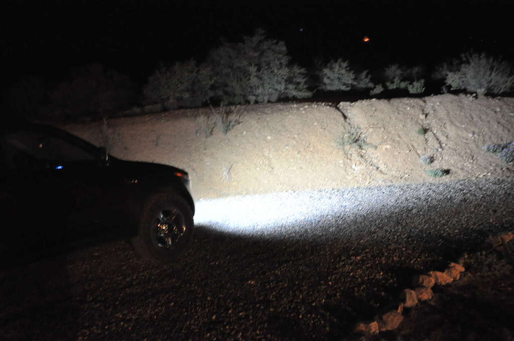

    HID LOW beam only:
    HID LOW beam and new LEDs:
    HID HIGH beam only:
    HID HIGH beam and new LEDs:

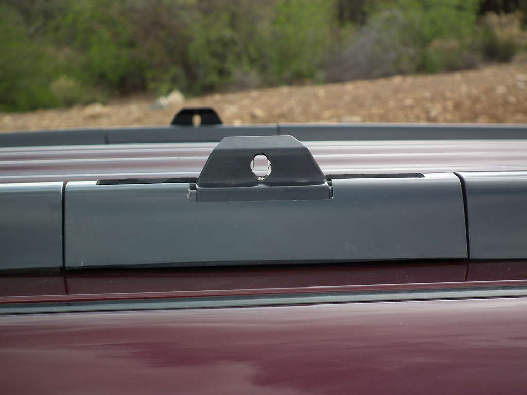

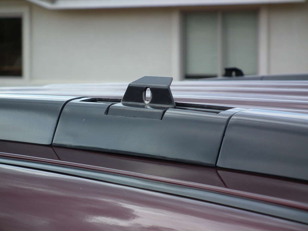

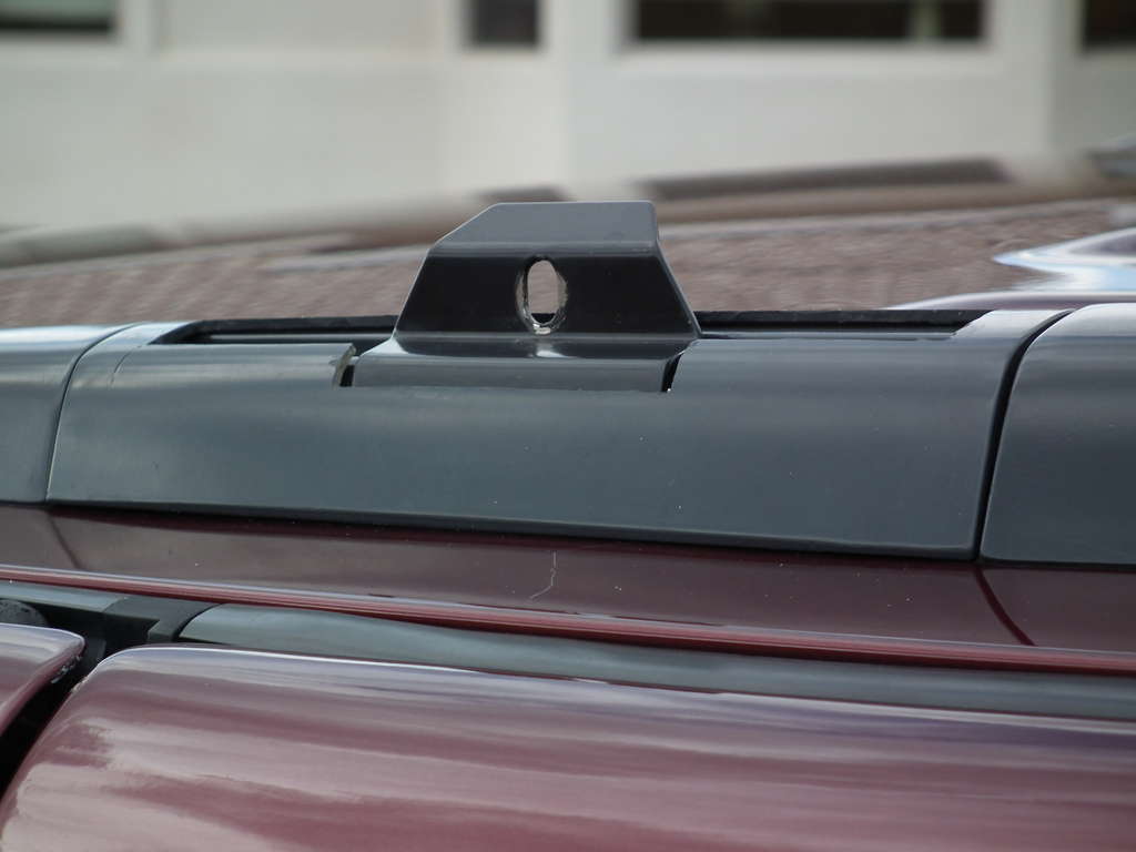

    ~ Used my dremel to cut down my rail caps a bit since the cross members tend to walk a little when installed, and the edges of the metal brackets were hitting the caps.

    These Vision-X "Solstice Solo Prime" lights are 2" wide and they don't fill it up. They added some gasket material and they're snug.
    These suckers put out 860 lumen! ...like I said, the pics don't do them justice.
