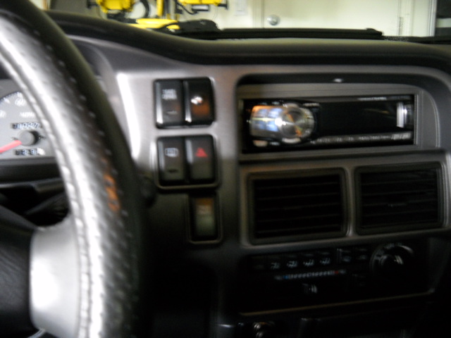

Change the aftermarket light switch from the Hella Optilux 20/20 to OEM switches...now all of my electical mods have OEM switches...

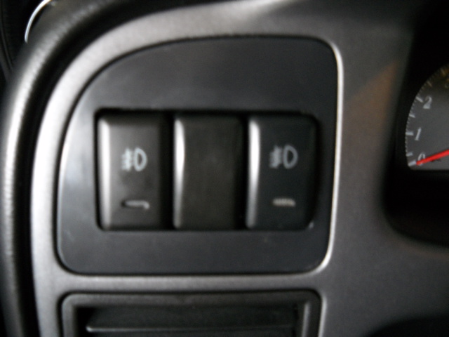

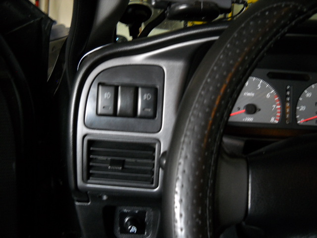

I did the 3 button mod around the same time. My bezel came from a '96 Rodeo., '97 Rodeo is same.
There's some slight differences in the footprint of the buttons, some are rocker switches which are slightly smaller footprint, instead of thes bulbous style push buttons.
Also, note, there's differences in the SWITCH and PIGTAIL you might find for the fog or rear gate release.
http://vehicross.info/forums/showpos...&postcount=624
These pics show the difference in the shape for the pigtail.
http://vehicross.info/forums/showpos...43&postcount=3
http://vehicross.info/forums/showthr...ht=pigtail+fog
