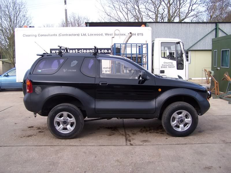

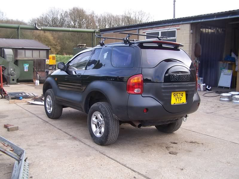

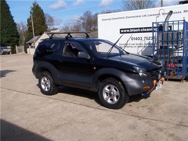

    and here is the lifted VX

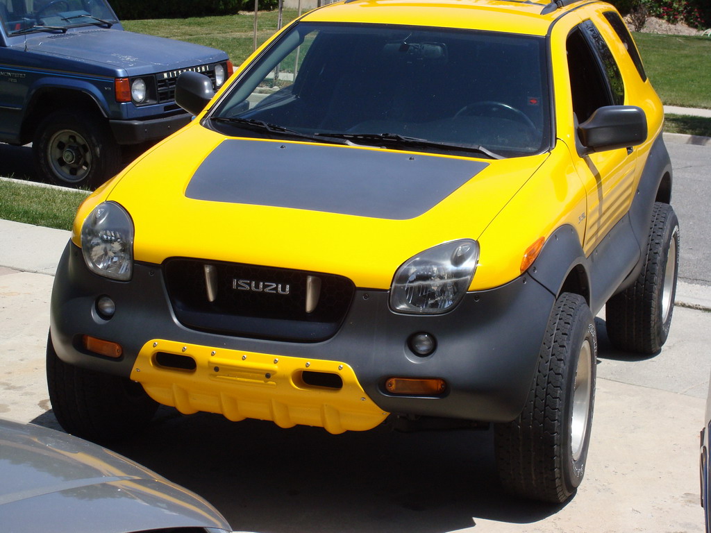

    Here is mine with a 285 and +18 offset
